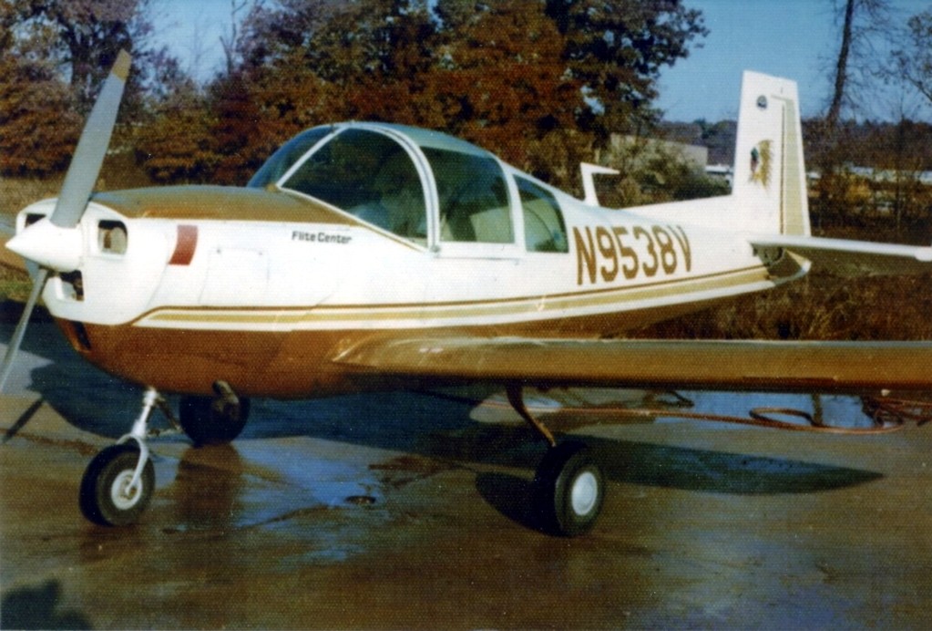

PostPosted: Sat Apr 11, 2020 2:00 pm
Posts: 4717
Interesting to learn that. Then there's the Mooney Cadet - which was a single-tailed Ercoupe. How was its performance affected by that change? My late uncle owned this one; I should have asked him:
the Mooney M-10 was intended to do everything a Ercoupe could not, it had a defined stall, where the Ercoupe just mushes, and I believe they could spin.
