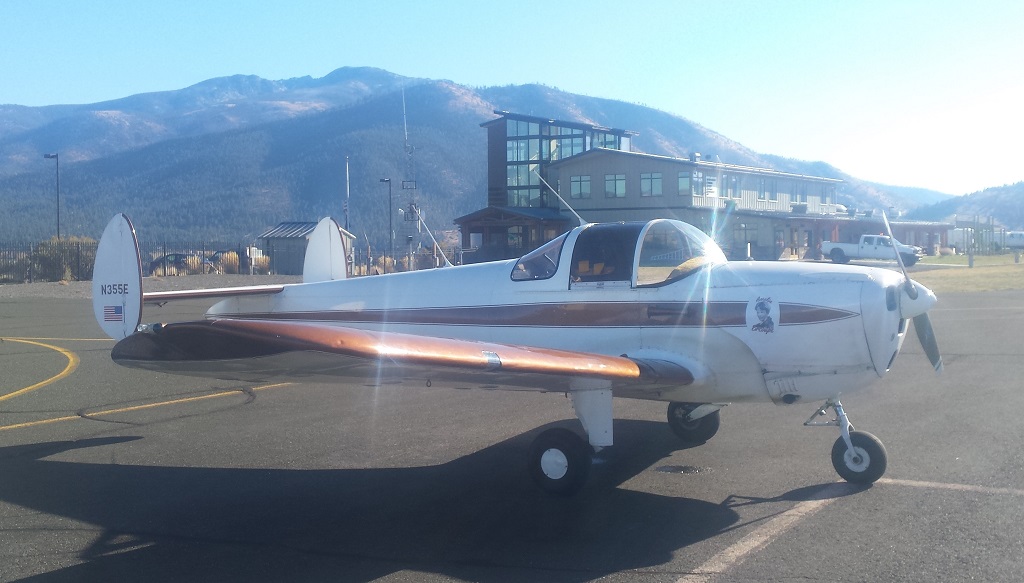

The Ercoupe does not have 2 rudders to make them "less" effective, it has 2 rudders that are outside of the influence of the prop slipstream. On a single tail plane, there is more air pushing on one side than the other because of the prop, if the rudders are further out than the prop diameter, there is no influence from the air. On a Ercoupe the rudders are linked to the ailerons, when you turn the wheel to the left, the left aileron rises the same as any other plane, the only difference is the left rudder moves outboard and the right rudder moves slightly inboard. The rudders move 20 degrees out and 3 degrees in.
One a plane like a 24 or 25, they are designed with rudders in the propwash as it make the rudders more effective in the event of an engine out, if the right engine is out, you carry more power on the left, more power means more air over the rudder.
I do know a little about Ercoupes, this one is mine. It is a 1950 model 415G, one of 8 left flying, It was built by Erco, which is the same company that made the nose and waist turrets on the PB4Y-2, and nose turrets on the PB4Y-1.

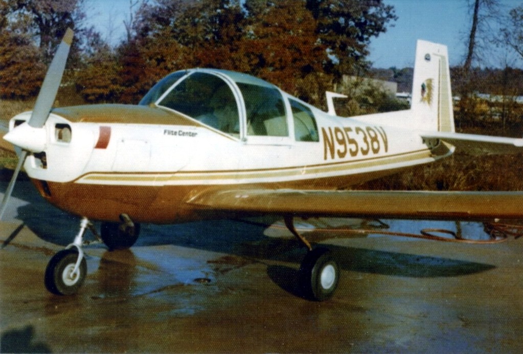

Interesting to learn that. Then there's the Mooney Cadet - which was a single-tailed Ercoupe. How was its performance affected by that change? My late uncle owned this one; I should have asked him:
the Mooney M-10 was intended to do everything a Ercoupe could not, it had a defined stall, where the Ercoupe just mushes, and I believe they could spin.
