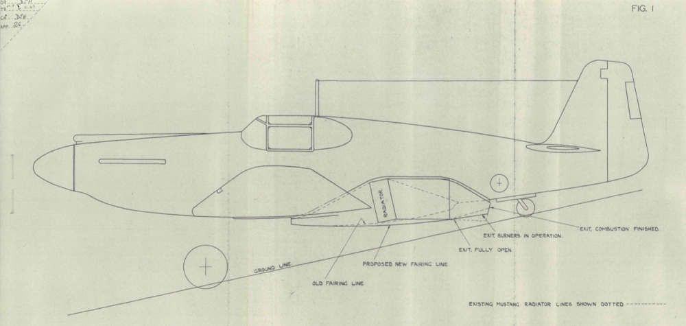

This is the original figure for the RAE report that put the Mustang's Meredith Effect on steroids.
PostPosted: Tue Apr 21, 2020 9:43 am
bdk wrote:
enginehistory.org/Installations/MeredithRamjet.pdf
Interesting that this more technical paper highlights the Bf-109 and Spitfire wing mounted radiator configuration more favorably for thrust than the deeper P-51 installation.
