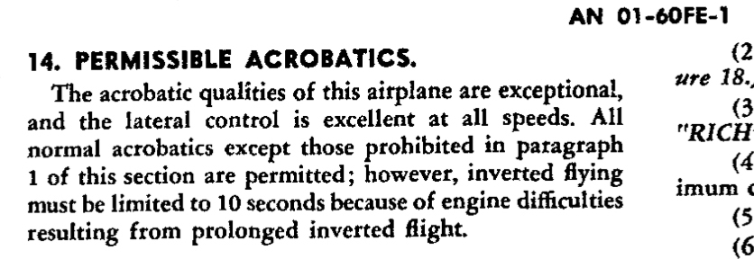

PostPosted: Thu Apr 30, 2020 6:26 pm
Posts: 3293
Location: Las Vegas, NV
Joe Scheil wrote:
The Mustang is an exceptional design. I use the word because it’s in the manual, stating the maneuvering characteristics are “exceptional”.
Looks like the manual writers at North American liked to use that word. Here's that same phrase in the T-6C manual.
I wonder what standard the T-6 and P-51 the exception from? :)
ellice_island_kid wrote:
PostPosted: Sun May 03, 2020 1:35 pm
Posts: 3299
Location: Phoenix, Az
In the T-6 if you are inverted more than 10 seconds, the oil pressure drops to 0. You can go full throttle and full rich to keep the fuel going to the engine for 15 seconds.
