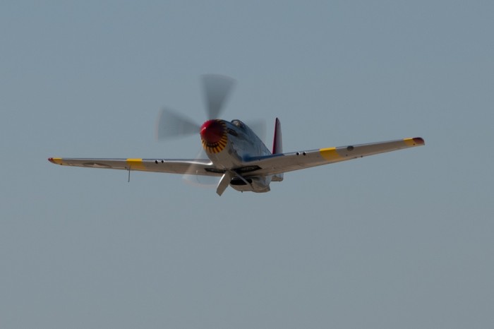

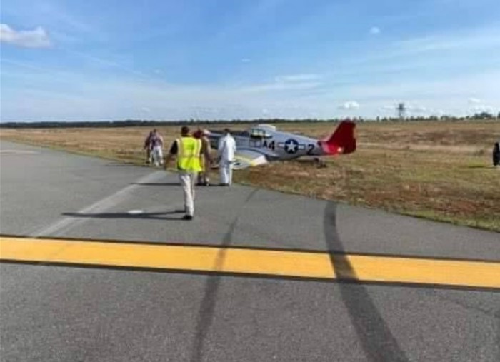

PostPosted: Fri Nov 05, 2021 11:56 am
Posts: 1525
Location: Williamsburg, VA
mike furline wrote:
Looks like the engine was shut down, preventing shock load, which is good; also looks like the gear trunnion didn't rip out or punch through the wing skin, which is also good.
Obviously it's not great to see her damaged, but if you HAVE to have an incident, it's good to see it wasn't more serious.

Posts: 519
When the gear folds like that I often wonder if that wing spar is bent - especially at the root - or the wing otherwise damaged/bent such that it has to be replaced. That's a lot of weight supported by the wingtip, on a long lever arm. Lots of force in the drag direction too.
