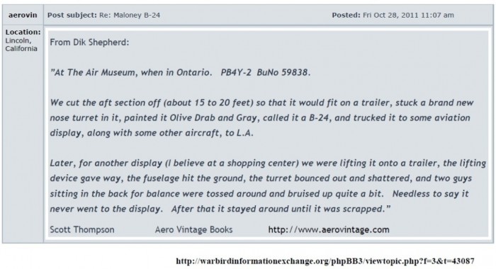

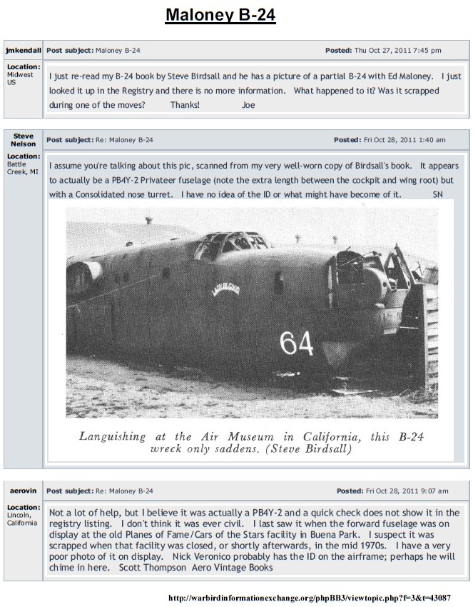

According to a WIX posting (Topic 43087) back on October 28, 2011 by Dik Sheperd, the PB4Y-2 that was formerly at The Air Museum in Ontario was BuNo 59838.
The following are from my files:

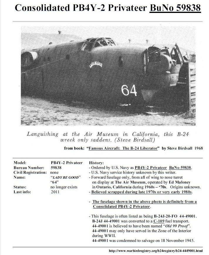

1 - PB4Y-2 BuNo 59838 - Warbird Registry entry - modified.jpg [ 233.53 KiB | Viewed 2444 times ]
2 - PB4Y-2 BuNo 59838 - WIX Maloney B-24 10-27-2011 a.jpg [ 220.56 KiB | Viewed 2444 times ]
3 - PB4Y-2 BuNo 59838 - WIX Maloney B-24 10-27-2011 b.jpg [ 134.87 KiB | Viewed 2444 times ]

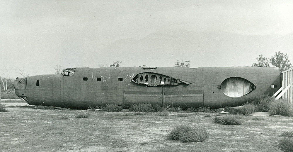

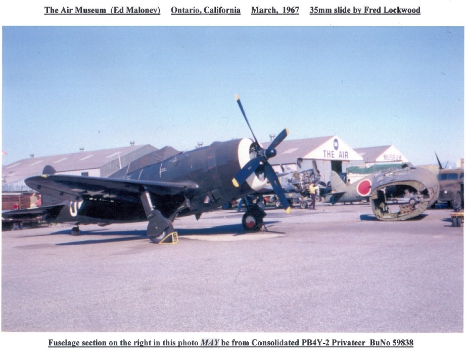

5 - fuelage section possibly from PB4Y-2 BuNo 59838 - The Air Museum - Ontario, CA 03-1967 b - Fred Lockwood.jpg
5 - fuelage section possibly from PB4Y-2 BuNo 59838 - The Air Museum - Ontario, CA 03-1967 b - Fred Lockwood.jpg [ 184.89 KiB | Viewed 2444 times ]

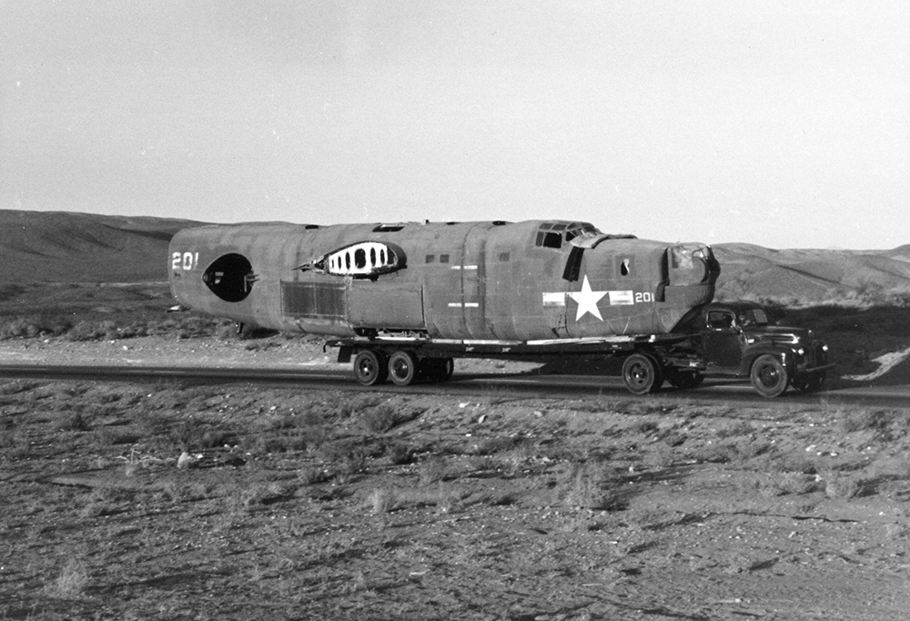

That said, I need a deeper dive on identifying this hulk, and please take a moment to examine the information I’m presenting:
I have attached a photo of the hulk being transported from China Lake to The Air Museum/Planes of Fame. The photo was given to Milo Peltzer by Ed Maloney.
As stated in the original post, 59350 to 59433 were delivered with the Motor Products nose turret. To those that have said, “A new turret was dropped into the nose section…” allow me to draw your attention to the fairing directly behind the nose turret. The hulk has the fairing for the Motor Products turret, not the Erco bow turret, making its serial number equal to, or lower than, 59433.
For a comparison, see Page 23 (Motor Products turret) and Page 26 (Erco turret) of the Ginter Naval Fighters series book # 93 “Convair PB4Y-2/P4Y-2 Privateer.” In addition to the fairing behind the turret, the area below the turret incorporating the bombardier’s windows is substantially different for aircraft 59350 to 59433 versus 59434 to 66324.
My apologies to Dik, but based upon the aircraft’s structural configuration, this hulk could not be 59838.
According to the record card, 59838 ended its days at Litchfield Park and was stricken from the inventory on 1Oct1956 (total time airframe: 3,541 hours).
Litchfield Park was closed and the base's aircraft inventory was either scrapped on site, flown out or moved to Davis-Monthan (MASDC) by September 1964 (see "Military Aircraft Boneyards," page 106).
Note that the distance from China Lake to Ontario is about 130 miles versus 350+ from Litchfield Park, Arizona, to Ontario, Calif., so I don’t see Ed Maloney spending his valued resources on transporting such a hulk (whatever its identity) from Arizona.
Yes, this is PB4Y-2 Privateer minutiae, but I'd like to know...
Appreciate your input and many thanks.
Nick
File comment: Maloney PB4Y-2 Privateer fuselage hulk being transported from China Lake to Ontario. Photo by Ed Maloney via Milo V. Peltzer

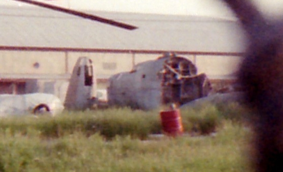

What about this one I shot in '83 - different plane?
PostPosted: Thu Oct 01, 2020 9:33 pm
Posts: 4341
I think that was an ex-RCAF B-24D, and endedcup either with Kermit Weeks or in the. Virginia Air and Space Center.
