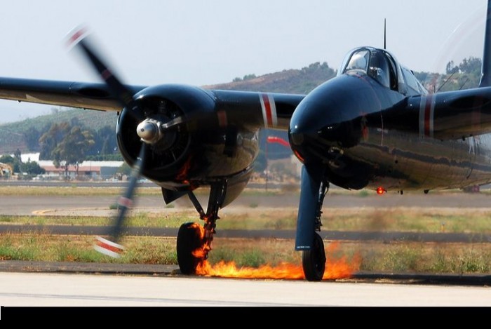

pppfffbbfftt...

Pretty typical example of a too-rich mixture burning off in the exhaust. Once the excess is out of the cylinders, the engine fires and blows out the fire.
The Tigercat is a tricky situation. A lot of radials manage to leak fuel during starting or dump any excess overboard after a starting attempt. If this then ignites you end up with something that you cannot sort out from the cockpit. I've seen this happen on a B-25 as well.

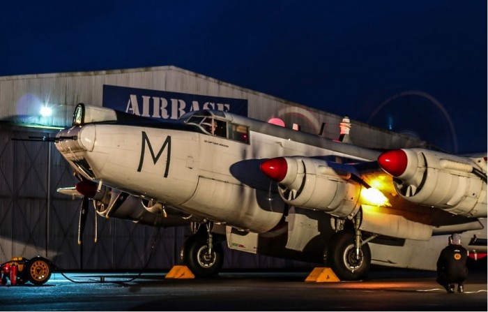

Happens occasionally on ours, especially to some that seem to think the primer button is like running a choke on a car. The worst one we had was when a gust of wind licked the flame under the cowling on one of the outboard engines and lit the fuel draining out the intake.
More often than not its a just brief flame, then gone again.
