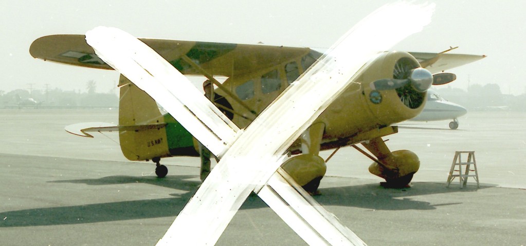

I found the negative for this shot in the trash at an estate sale many years ago; from the rest of the stuff I found it was taken in southern California, probably in the late '60s. Anyone recognize it?
ETA: Found a shot that seems to match; N5553N/msn 978:
http://www.flugzeuginfo.net/acimages/ho ... ying12.jpg

And Chris Brame, thank you for the colour photo of the NH-1. It's quite the striking paint scheme.
