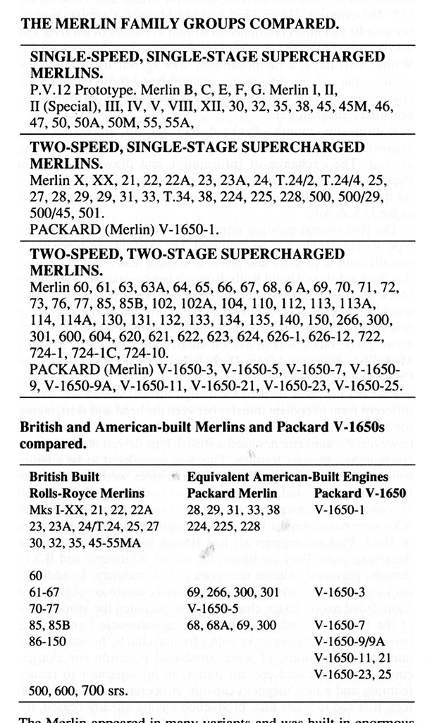

While I can't exactly answer your question, this chart may help some. It is from page 201 of "British Piston Aero-Engines and Their Aircraft, by Alec Lumsden, 1994. The bottom chart says that the 266 was the V-1650-3 equivalent. For what it is worth.
Randy
Added from page 213 of the same source.
"MERLIN 266, 1,315 hp. This two-speed, two-stage engine was a Mk 66 with the same ratings but built by Packard. With the same ratings, it was a low-altitude engine. It had the usual Packard features, interconnected engine controls and Stromberg injection carburettor. Propeller reduction gear .479:1. Rating RM.105M"

Randy Wilson wrote:
Randy
Many thanks it is just perfect!
