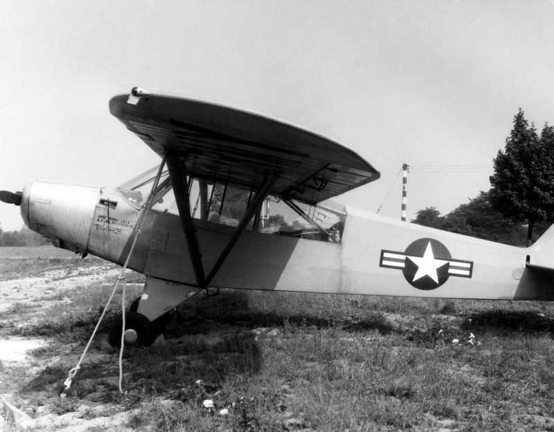

There were four variants of the Piper Super Cub that were "touched" by the US military.
The L-18 was the military version of the PA18-90 with a Continental C-90, 90 hp engine and no flaps.
The L-21A was the military version of the PA18-125 with a Lycoming O-290, 125 hp engine and NO flaps.
The L-21B was the military version of the PA18-125 with a Lycoming O-290, 125 hp engine and flaps and instruments and radios to be an instrument trainer.

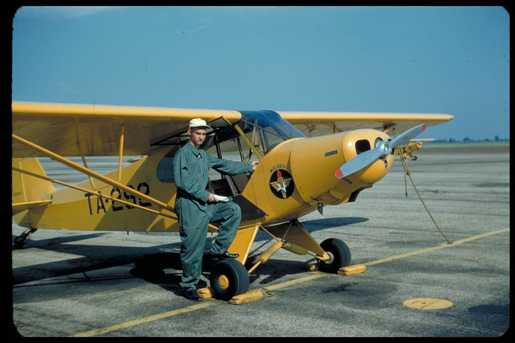

While not a part of the original poster's question, the USAF had the most experience with the PA18-105(Special) version of the PA18-105 with a Lycoming O-235, 105 hp engine and no flaps. It was used for several years as a primary trainer and carried civilian registration of N + 3digits + T (the one pictured is N292T). Because of the registrations once surplused they became known as "Tango birds".
