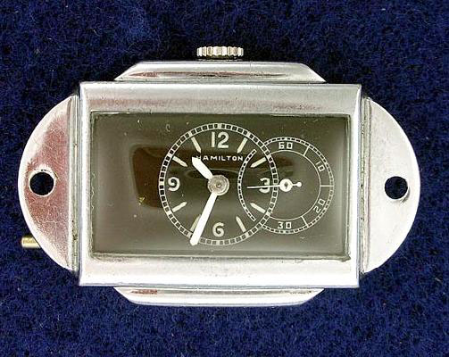

For what it's worth, here's some information on the special Hamilton watch integrated in some of these cameras. The dials were made in both horizontal and vertical formats. I restored many of these during my career as a watchmaker. Many collectors today opt to use them as wristwatches by bolting a strap to the mounting holes.
