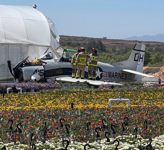

Does that T-28 look good enough to rebuild ?
PostPosted: Wed Jul 27, 2022 10:36 pm
Posts: 2683
Anything is rebuildable, but the cost would exceed buying a flyer.
I presume with the visible damage to the aircraft that it came to a sudden stop to cause the associated injuries.
There are a lot of T-28 spare parts around. The gear was in transit when the plane crashed so that may have resulted in quite a bit of damage you can't see from the perspective of the one photo.

mike furline wrote:
Hard to tell for certain in the photos but didn't look like much of a ground scar - likely hit pretty hard. One report said it took over 20 minutes of prying with tools to get the rear canopy open to access the passenger.
Medical examiner report said the passenger died of blunt force injuries, so I suspect that either the harness failed or wasn't secured properly.

Fearless Tower wrote:
mike furline wrote:
If he put it down that hard as the gear was nearly up at the time of impact and it just slammed down could have just broken their neck.
