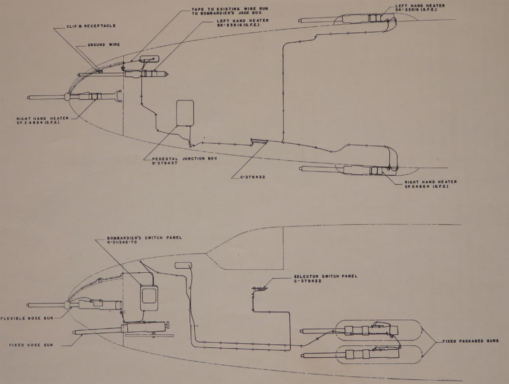

Do you have any drawings or diagrams showing the MG brackets inside package gun pods?
PostPosted: Sat Jul 25, 2020 9:54 pm
Joined: Wed Apr 15, 2015 8:11 pm
Posts: 74
For the actual brackets, I do not. I do however have this diagram for the heating elements for the guns, hope it's useful.
