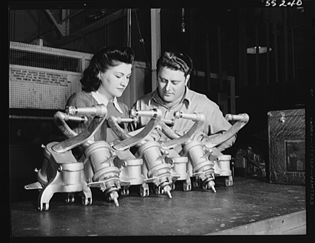

The size of the assembly was pretty big, This photo will show it.

The P 51 tail wheel is most likely located further forward than other aircraft because of how much weight is on the tail. The radiator is well aft of the cockpit and CG making the weight imposed on the tail wheel fairly significant. Therefore a significant amount of structural framing is required to prevent the fuselage from being damaged if the tail comes down hard. It’s also why it has the shock absorber to absorb that load and disperse its energy over distance. The empty weight of the mustang is well over 7000 lbs.
The spitfire radiator was located in the wing and therefore much closer to the CG. If you look at the tail cone design of both airplanes, you will see the mustang has a lot more weight aft of the CG.
