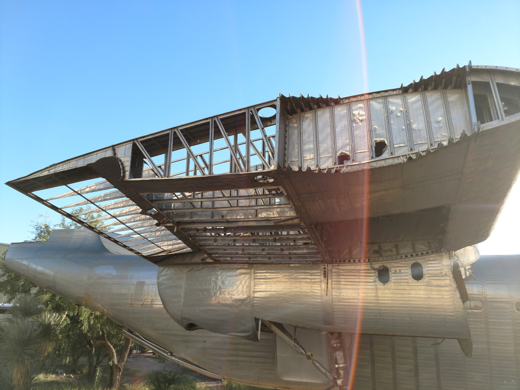

I know hindsight has revealed that stainless steel is not the best material to build airplanes out of, but they do have one advantage I find fascinating. Even after years sitting outside, aside from mechanical damage, they look pristine with zero corrosion. I first discovered this when I saw the Budd RB Conestoga at the Pima Air and Space Museum in November 2018:

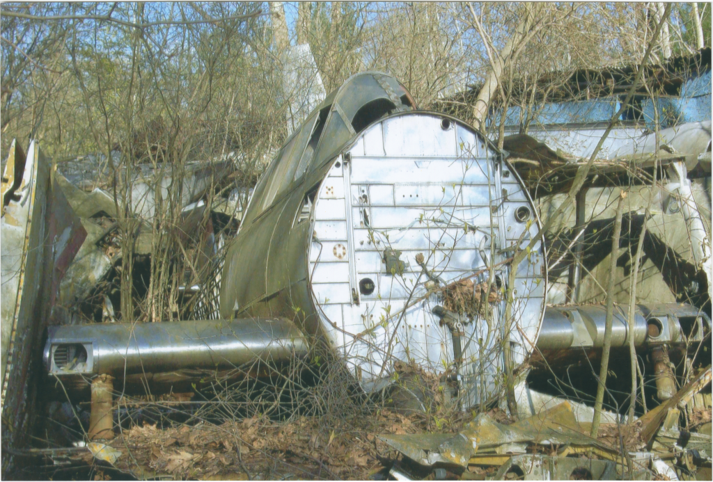

I recently noticed it again when posting a picture of the Fleetwings XBT-12 Sophomore that was in the Soplata Airplane Sanctuary collection:
(Source: Warbird Information Exchange)

PostPosted: Thu Mar 10, 2022 1:49 pm
Joined: Wed Jun 01, 2011 11:23 am
Posts: 700
MiG-25 was made of stainless steel, since it was intended to do Mach 3+, which would drastically weaken aluminum but the Soviets didn't have the proper titanium skills and resources.
PostPosted: Thu Mar 10, 2022 3:18 pm
Posts: 144
Although primarily known as one of Britain's largest wooden aircraft, the General Aircraft Ltd Hamilcar glider had the majority of its metal components made from Stainless Steel.
PostPosted: Thu Mar 10, 2022 4:15 pm
Posts: 2061
XB-70 is all stainless
PostPosted: Thu Mar 10, 2022 4:25 pm
Posts: 1706
...and the Bristol 188.
