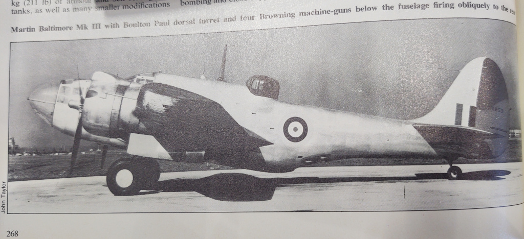

Another picture of the aircraft with the same unusual registration - and a rudder in RAF camouflage - appears in the book Weapons and Warfare:
(Source: Bernard Fitzsimons, ed., Weapons and Warfare, vol. 3, 24 vols. (New York: Columbia House, 1977), 268.)
While American aircraft registrations began with two letters until 1948, outside of the above instances I have never seen three letters.[1] (As an aside, it reminds me a bit of the three digit Wright Field designations in that they both appear to be an extension of existing systems outside of the "rules".) The original poster of the Baltimore picture was confused as to what the "M" could have stood for. However, with two data points, I have a theory: the third letter was taken from the manufacturer's name. In other words, "G" for Grumman, "M" for Martin. Furthermore, both of the pictured aircraft were likely intended for export. As proposed by someone in the Secret Projects thread, it appears as though these were temporary registrations. To speculate a bit further, it is worth noting that the pictures were likely taken before the United States was involved in the war. (As evidence of this, another G-36, NX-G1, was pictured with French roundels. These would have been replaced with the British ones seen above when France capitulated - in 1940.) Equally important, both aircraft types were acquired by the "Anglo-French Purchasing Board". At this time, the United States was still trying to appear nominally neutral and forced the commission to purchase materiel via the "cash and carry" policy. Therefore, taken as a whole, the civilian registrations seem to be an attempt to have a façade of neutrality. In other words - unlike under the later lend-lease program, where aircraft were nominally taken on strength with the U.S. military and briefly given a USAAF serial number before delivery - the G-36 and Baltimore were being sold by private companies, under civilian registrations, to a foreign government, that the United States government was in no way involved with.

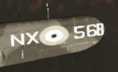

NX95B, with a hilariously "squished" registration.
Close. :wink:
