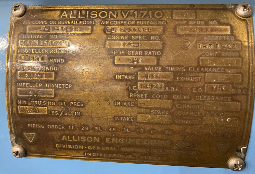

Hi Buz,
This engine is held by the Ferrymead Aeronautical Society, Christchurch, New Zealand.
It was obtained from a power boat racer who had used it in his race boat. As he had acquired it from the post WW2 disposal here in NZ it must be out of a P40.
Hope this is of use/interest
regards

PostPosted: Thu Jul 07, 2022 4:23 am
Joined: Mon Nov 29, 2004 8:36 am
Posts: 126
Location: Not Canberra, Australia
Denys
Thank you, just what the Dr ordered. If interested that engine was fitted to a P-40E-1 41-25128, which was used by 68th FS (aircraft later became NZ3098). If you're in contact with Ferrymead Aeronautical Society please let them know which aircraft (if they are interested and don't already have the info)
Buz

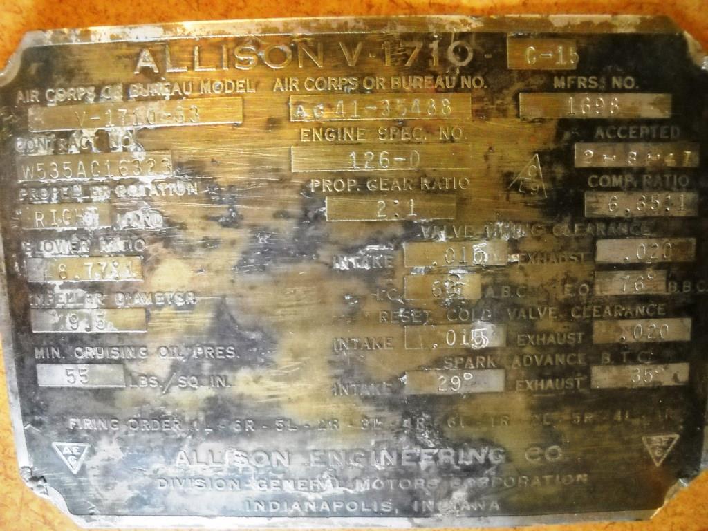

A good friend has a flying P-40. I didn't pull panels to get to the data plate for the engine on the airplane, but this is one of his spare engines.

PostPosted: Thu Jul 14, 2022 4:38 am
Posts: 126
Thank you I had the engine number for this one but not the FY (it confirmed what I thought, but confirmation is better than an educated guess) - if you happen to find out what engine he's running that would be awesome.
To the plate you posted this was fitted to P-40E-1 41-25141 (later to the Royal Australian Air Force as A29-101), not 100% sure when it was removed from the airframe (this one was damaged a few times), engine last seen at CMU Tamworth in 1945 before being sold by DAP. Might send you a PM if ok, I'd just like to confirm something with you.
Buz

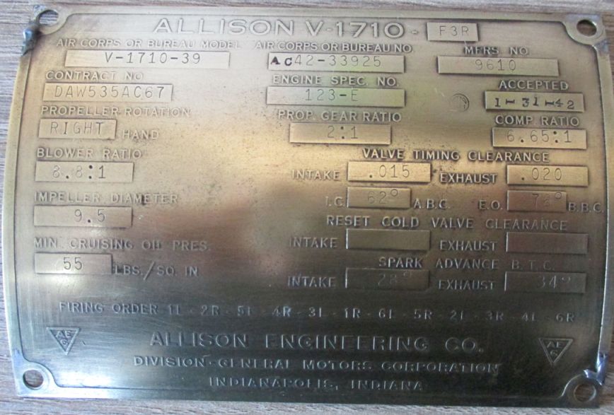

Engine Data plate recovered from Alison 1710 engine in Kailua Bay from P-40B/C wreck. Unknown serial number of aircraft. If you can help match it to the aircraft serial number it would be much appreciated.
PostPosted: Mon Jul 25, 2022 3:53 am
Posts: 126
Dave
Thank you, I'm still looking for this one for you, just haven't found a way to crack it as of yet (but there's many more files to go through - although AFHRA have slowed me a little with the change of rules) - PM inbound
Buz
