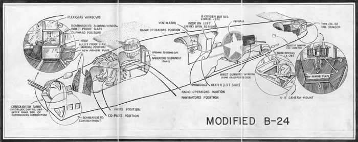

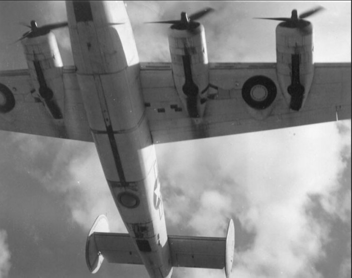

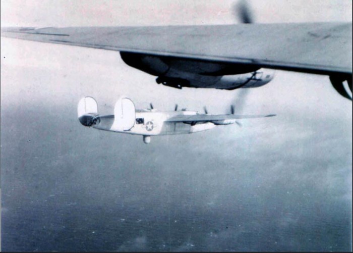

I have only just discovered this discussion, but I see several years have passed since the last post, so I hope I am not repeating information you might already have turned up since then. My particular interest is in the anti-submarine B-24s and PB4Y-1s of the AAF and USN which operated from Dunkeswell (England) during late 1943 and the first half of 1944. All were fitted with a retractable SCR-717 radar for hunting U-boats, as visible in the attached photos (via Festningsverk Militarhistorie). The attached diagram shows the modifications made to the USAAF aircraft, which were carried out at either the Northwest Airlines facility at Holman Field, St. Paul, Minnesota or at Middletown Air Depot in Pennsylvania. I have a few more photos of Dunkeswell-based aircraft, but have so far found next to nothing on the radar operator's station or the equipment mounted in the waist area. I gather it was also carried on the P-61 night fighter. I hope this is of some help.

Just learning how to upload photos! Here is the diagram I mentioned.
