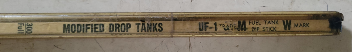

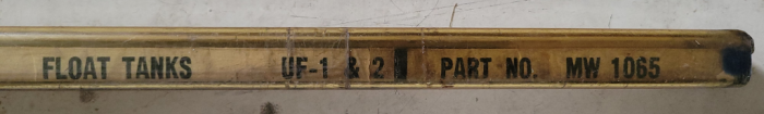

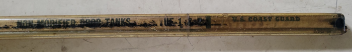

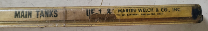

While checking out the museum's new Albatross today, I came across something that, while not strictly speaking a load adjuster, is something that reminded me a lot of one: a fuel tank dipstick. The reason I found it so interesting is that I have never seen an honest-to-goodness, commercially produced, vintage example before. Pretty much everything I've encountered up to this point, whether crude or well constructed, has been some sort of replacement. With extensive and heavy handed use, I presume the originals just wore out quickly and were discarded. Anyway, the revelation was that there is probably a whole series of these "liquid measuring gauges" specifically designed for each aircraft. (Which seems to be confirmed by an auction listing for a DC-3 dipstick by the same company.) A brief Google search for "Martin Welch & Co" turned up an interesting court case involving a dispute over the invention of the device that shed useful light on how and when it (supposedly) originated.
IMG_2025-03-25_10-57-26 (Cropped, Reduced, Converted).png [ 80.62 KiB | Viewed 9614 times ]
File comment: Main Tanks
IMG_2025-03-25_10-58-43 (Cropped, Reduced, Converted).png [ 228.54 KiB | Viewed 9614 times ]
File comment: Float Tanks
IMG_2025-03-25_10-58-53 (Cropped, Reduced, Converted).png [ 209.48 KiB | Viewed 9614 times ]
File comment: Non-Modified Drop Tanks
IMG_2025-03-25_10-59-05 (Cropped, Reduced, Converted).png [ 211.35 KiB | Viewed 9614 times ]
File comment: Modified Drop Tanks
