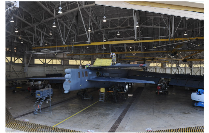

B-52s and KC-135s have that feature. Boeing must have liked it.
At my time at a couple of B-52 bases, I only saw folded fins a couple of times.
A USAF article on the B-52 feature:
https://www.barksdale.af.mil/News/Featu ... x-and-fly/
I
And one on a KC-135:
https://www.afcent.af.mil/News/Photos/i ... 000876165/
And from Google a copyright-free USAF photo for your piece.
The story of that various twin and triple tail types went with the feature to allow them to use existing hangars, but wouldn't a folding fin night make more sense considering the extra drag and weight of the multiple fins?

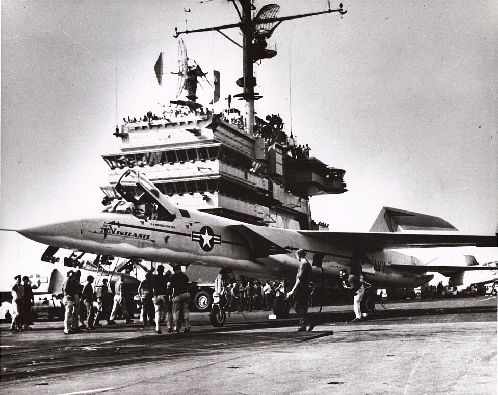

The North American A3J / RA5C Vigilante had a folding vertical fin.
North_American_A3J-1_Vigilante_during_trials_aboard_USS_Saratoga_(CVA-60),_in_July_1960.jpg
North_American_A3J-1_Vigilante_during_trials_aboard_USS_Saratoga_(CVA-60),_in_July_1960.jpg [ 229.25 KiB | Viewed 3270 times ]
C2j
