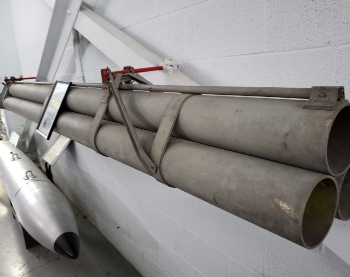

Hi I was wondering if anyone knew where, if any, M10 Rocket Tube launchers existed? It would be nice to try and get a closer look at this weapon system setup. I can't seem to recall seeing any on display, only in vintage WW2 photo. So I figured I'd ask the WIX brain-trust. Does anyone recall seeing them on a museum display aircraft, flying warbirds or a private collection? I believe they were made of plastic, making them light weight and basically made to fire the M8 4.5 inch projectiles. Thanks

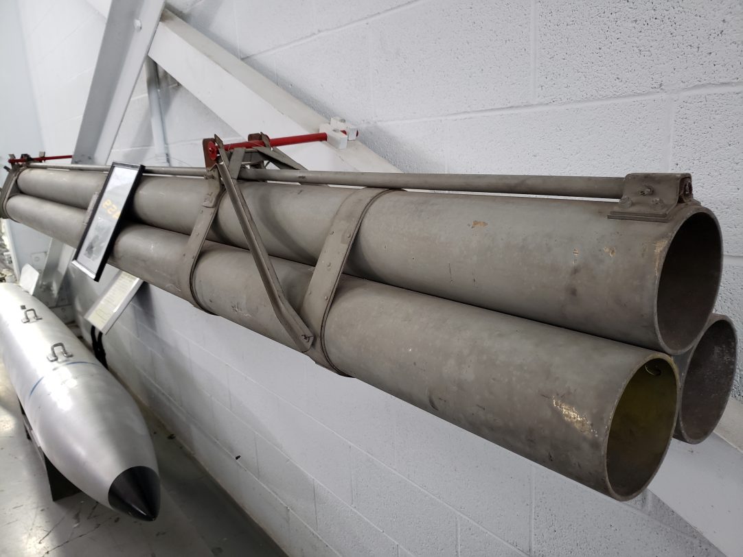

Shay: MAPS has a set hanging on a wall display.
https://mapsairmuseum.org/wp-content/up ... 963732.jpg
Thanks! Funny I was just recently up there for a militaria event hosted by the museum. Wish I had noticed it when I was there. Just another excuse to go back. :)

Per TM 9-395, the M10 launcher tubes are plastic. The M14 launcher is identical, but steel tubes and does not have a couple of the guards and deflectors the M10 needed for positive jettison from the aircraft.

The one in the MAPS museum collection has some spots where the paint is worn off, and the texture there looks like what you see with resin impregnated cloth construction. Like an M1 helmet liner.
