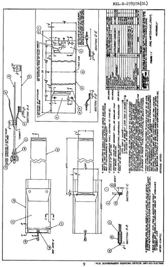

Looking to see if anyone has or knows where I can get a copy of the standard part drawing for the A-1 Message Drop Bag? Listed part number is 065169, and was a GFE item for the L-birds. I've actually got an original one on hand, but would like to see if I can find a copy of the drawing before I delve into doing one.

Bag, Message Drop, Assembly MIL-B-27897
SC-D-61004
27 June 1962
Like this?

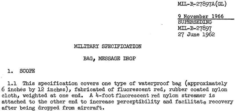

Mon Oct 23, 2023 1:06 pm
Here is the scope of the drawing
Cancelled
6/18/1982
MILITARY SPECIFICATION BAG, MESSAGE DROP. Specification MIL-B-27897A(GL), dated 9 November 1966, is hereby cancelled without replacement. Preparing activity:. Army - GL. FSC 1670. vw U.S. GOVERNMENT PRINTING OFFICE: 1982—505-022/3339 2-1. THIS DOCUMENT CONTAINS __/ pages.
PM your email address if you want a copy of this specification/drawing.
Re: looking for a standard item drawing...Message drop bag
Mon Oct 23, 2023 1:25 pm
Wonderful BDK..... What am I going to do when you retire and loose access to that phenomenal tech library you use? PM headed that way.
That's for a bit bigger bag, but it's close enough that I can work off of it. The originals were I think a 4x6 bag.
