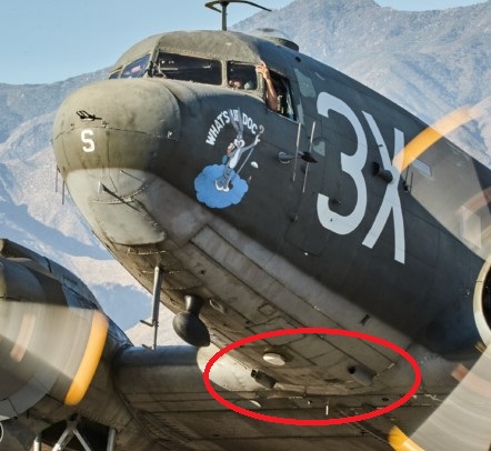

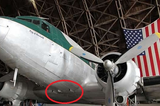

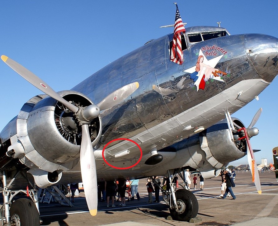

Yeah, OK. They're air scoops/inlets.
In all the pictures I've searched, the do NOT appear in WWII period pictures.
They only appear on some C-47's (never DC-3's). I'm guessing those had a postwar civilian history?
What are they for / what do they ventilate?
Does anyone know a specific installer?
C-47B_Skytrain_-serial_43-49942_Bluebonnet_Belle-26Oct20082.jpg [ 254.91 KiB | Viewed 4925 times ]
Thank you in advance to the WIX Brain Trust!

C-47s with hot air heaters had the scoops on the belly of the airplane for mixing cold air with the hot air from heat exchangers from the exhaust stacks. Earlier versions of the C-47 had steam heaters and didn’t have these scoops. Here are a couple of pages from a C-47A Flight Manual that mention the belly scoops in the text.

From your information, I was able to dig deeper into this. I find that from C-47A-25DL onwards (including C-47B's) the "improved cabin heating" - i.e. a heat muff on each exhaust - system was installed (MANY thousands of airframes). This leads me to a follow up question:
Was there a modification that deleted these from some post war C-47's? I ask because they are not present in all pictures of all civilian C-47.
