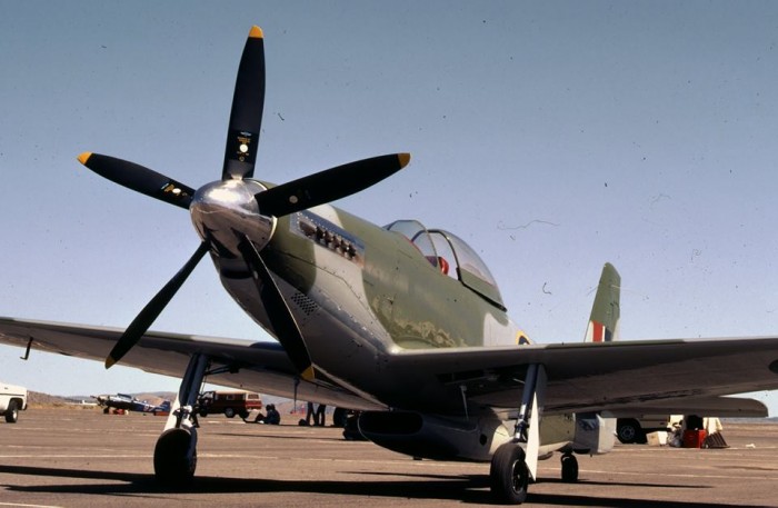

The pic of Zero EB-200 (#3372) was just too good not to sneak in! Thanks for posting!
