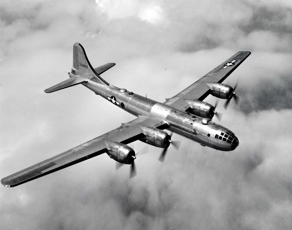

The main wing skins (with the exception of the trailing edge above the flaps) on B-29 Doc were already painted silver when it arrived in Wichita after its long desert storage. Whether that happened at the factory or as a T.O. while still in service I cannot say for sure. It is my opinion that was done during the original build.
B-29 Doc arrived with unpainted, polished Alclad skins at the outboard side of the outboard wing panels (the outboard wing panels are not part of the main wing, and are roughly the last 26 feet of wing), just like the common B-29 publicity photos taken when new. So, on a stock B-29 you will see Alclad main wing trailing edges, painted main wing skins above the fuel cells (in between the forward and aft spars). And a mixture of both on the outboard wings. The heavier outboard wing skins that have the 82 degree countersink angle are painted, and the furthest outboard skin that are thinner and utilized a 100 degree countersink angle was Alclad.
They painted those few Alclad skins during restoration probably for maintenance and durability.
If the main wing skins are not painted, there are fuel cells underneath each one, and any rain seeping past rivets will collect and be trapped in the fuel cell compartments. Keep in mind, too, that the wing does not shed rain water as quickly as the fuselage does.
The B-29 was not a completely bare airplane, it just seemed that way. Inside of the main wing amongst the fuel cells was zinc chromate primer. Inside of the outboard wings the spars and stringers got painted gray lacquer, with the trailing edge formers were bare. The horizontal stabilizer was similar with the gray lacquer on the spars and stringers (the most important parts).
