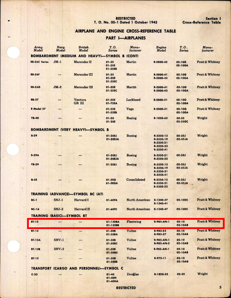

You should reach out to Ester Aube of AirCorps Library. Every once and a while, she has included requests for documentation from a member to her weekly update emails. An example is below:
(Source: Email)
You should be looking for T.O. 01-130BA and T.O. 01-130BB:
(Source: AirCorps Library)
