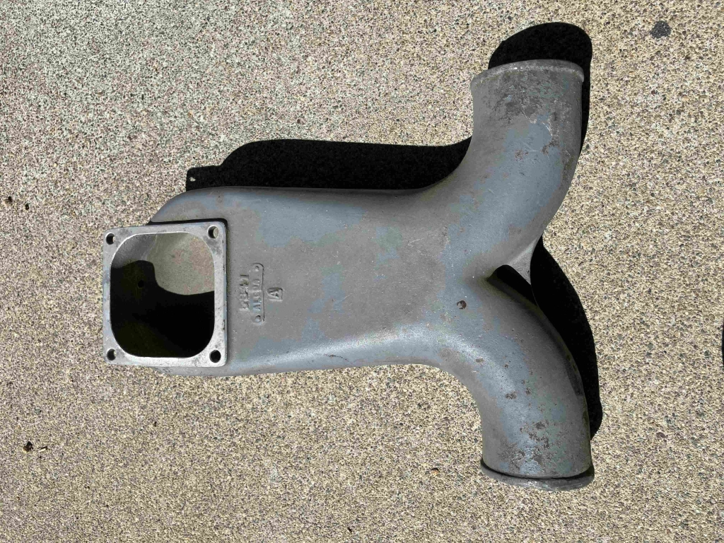

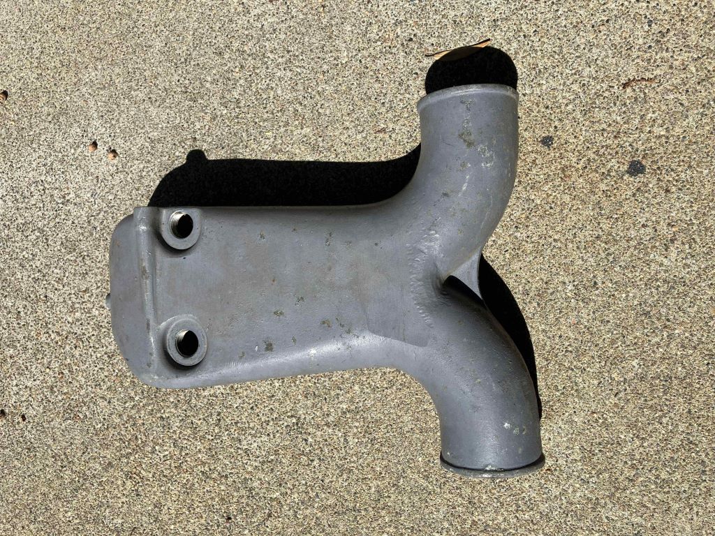

I obtained this air box in a pile of parts and thought it might be for a Stearman, but have no clue. The mounting holes match a Stromberg/Bendix NAR6G carburetor that the Continental W670 uses, but I don't see any photos online that match this part. Any ideas???

It is part of the induction system for the LVT (landing vehicle, tracked) which used a Continental 220 variant for a Powerplant.

Posts: 25
After further research last night I had come to the same conclusion. Thanks for the confirmation!
