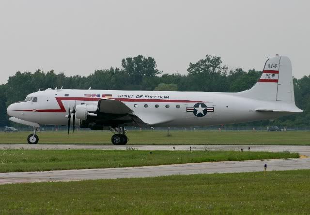

What's your Gemini program then? Gemini was always my favorite of the NASA programs. :wink:
The C-54 is beautiful. I made sure to stick around long enough at Thunder Over Michigan so I could watch it taxi out and take off.
