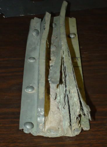

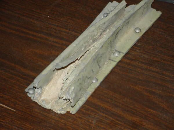

Hey Gary,
How's this for corrosion!
That's a chunk of B-29 spar or wing rib. Can't say definitively as they kept making changes to the wing during production, and the only detailed interior photos I have are of early production wings (XB-29, to be exact!). But I'm betting wing rib, what do you think?
That peice came out of Pyote from one of the scrapped -29's, and it layed in the field there until the 70's. No idea when that corrosion started, but it's pretty nasty nonetheless!
Trevor

B29Gunner wrote:
Hey Gary,
Trevor
Actually, there are four primary stringer extrusions used on the B-29 (the B-29A, like FIFI anyway). The piece you have looks to me like the type that's primarily used in the cockpit section. They are also used throughout the rest of the fuselage, but mostly in the cockpit from what we've seen.
With the exception of the spars, the components in the wing are quite thin (they start at .020" and go to .040"). Darn near scary lookin' if you were to just see one rib at a time. But they make up for it with quanity and doubling them up. For example, there are 44 ribs just on the aft portion of the rear spar. I know this because we had Odegaard Wings fabricate them for us to install on our left, outer wing panel last year. :?
Gary

Very interesting photos.
