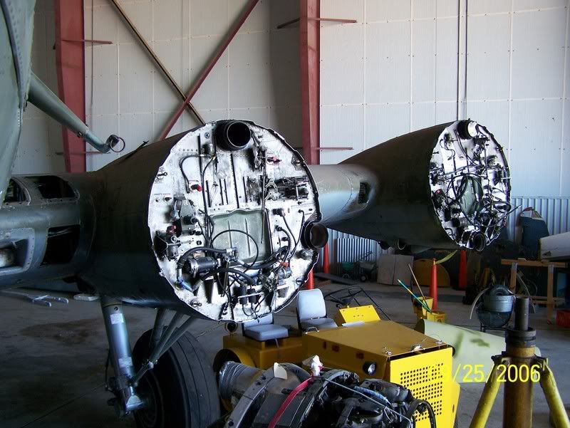

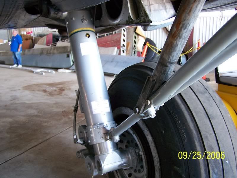

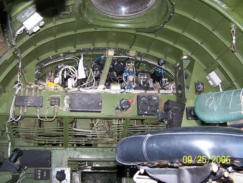

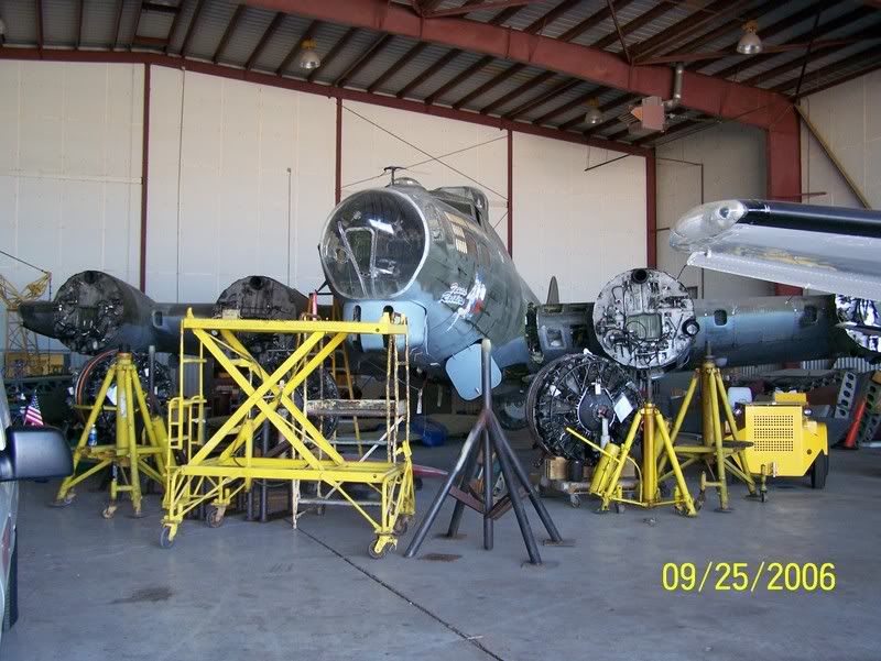

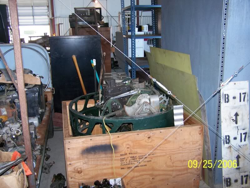

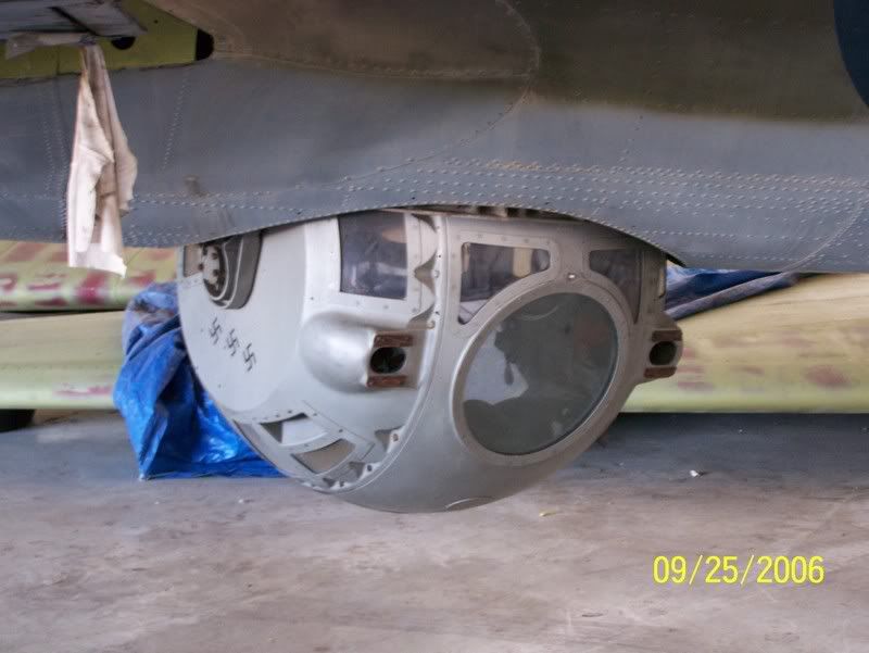

I had been in Houston several weeks ago and wanted to give an update on Texas Raiders. She is at Houston Hobby at Craig Aronsons' hanger. Craig will be assisting in finishing the airplane. Lots of work to do, but they are on track. They pressure washed and scrubbed the old girl last week. Stripping, corrosion treatment, repair, zinc chromate, and repainting are planned. They do have a complete, operable top turret, but that may yet wait for a while...... for John, the ball turret does rotate as seen in the picture..... Alan
They have lots of spare parts to resort and store. Just takes time....

Al,
Thanks for thinking of me when you took the pic of the ball turret :wink: ...it looks beautiful!!!!
Just out of curiousity does it have all the internal "guts". I would assume so since you mentioned that it does rotate.

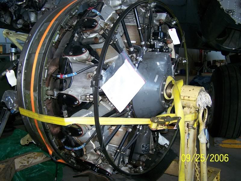

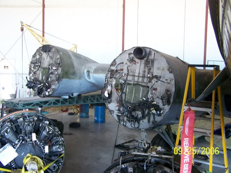

I was under the impression that Raiders was down for the spar AD only. It looks like it's getting fresh engines as well...possibly some new wiring? Can you give me/us a comprehensive update on what has been done to it and what is planned and yet to be done?

Thanks Alan. Were the engines overhauled or are they spares?

Hey John and Superfort! The engines were previously operational, but pickled and stored. I do believe at least one, possibly two were very low time (after overhaul) engines. The AD was in a way, the least of the issues.... it was the terminal ends that created the bigger problem. The inner portion of the terminal end fits inside the square spar and it is bolted together. The outer end actually bolts to the fuselage. Several of the terminal ends were corroded beyond limits. No other B-17 to date had this issue arise to the point where a replacement part had to fabricated. Of course all with the blessing of the FAA. The GCW website has a pic of one of the terminal ends before it was finished being machined, then remated to the spar. Hope this helps a little.. John waiting for a new update on Redtails.... DR said you guys were cutting metal on wingribs... Alan

John, I have another Houston trip in about 1-2 months... I'll try and get some really detailed shots of the ball turret inside and outside. Alan

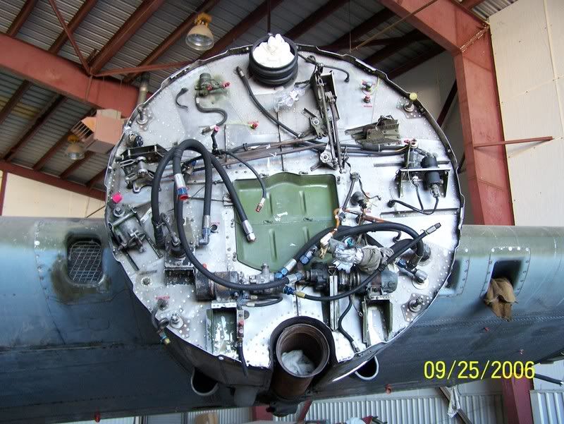

I'd love to see close ups of each of the firewalls - not an easy shot to find in reference books. :wink:
NICE bird! Thanks!

Looking through the pics, I can fill at least one request... so here goes!
Firewall detail for #1 engine.

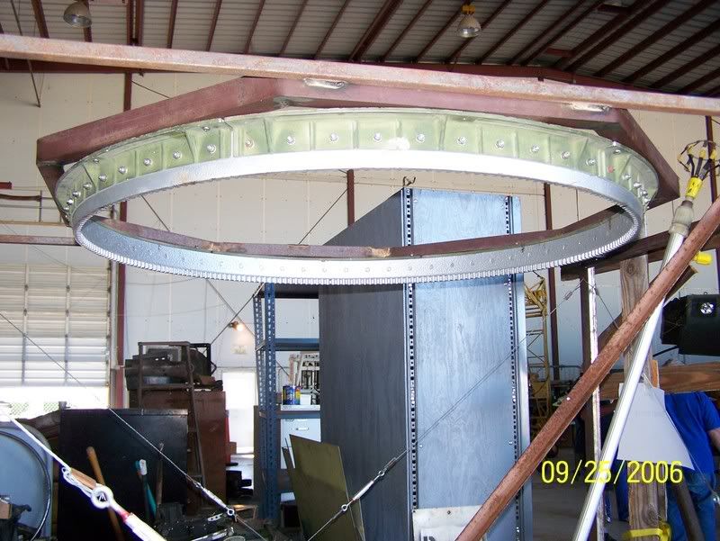

Upper turret in the box.
Upper turret ring.

THANKS Al! Are there differences between the inboard and outboard firewalls? If possible I'd love to see more of the firewall shots. Any chance you can email to me directly? (slobber slobber)

Ok Derek, this is the best compromise I could find on my pics... Alan
#1 & #2.
#3 &#4.

Thanks so much! Very helpful shots!
