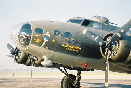

The "G" was also the first of the models to have enclosed waist gun windows. Also on the "F" model, the ADF "football" antenna was located forward of the front crew hatch..and the "G" is located aft of the hatch. The cheek guns were also different.
Although this B-17F is actually a G, made into an F.
