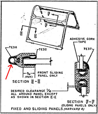

PostPosted: Sun Dec 15, 2013 12:23 am
Posts: 668
Sorry to bring up an older thread, but does anyone have a source for the 7E36 (C281?) extrusion as used on the front sliding canopy? I know Banaire used to have it, but I can't seem to find it or anything close.
Thanks in advance!
:partyman:

Which one is that?
PostPosted: Mon Dec 16, 2013 12:19 pm
Posts: 668
It's the one that goes on the front edge of the front sliding section to seal against the windscreen.
:partyman:

PostPosted: Tue Dec 17, 2013 12:50 am
Posts: 3160
Last I got from Lance but it didn't fit the best. They can be a pain to insert in the groove.
