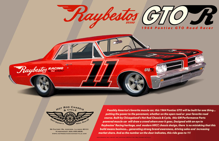

My rendering of what the finished give-a-way car will look like. Anyone can enter to win. We're planning on debuting it on the PowerTour.

Wow, that is a very impressive build. Pretty cool to see you ditch the frame all together and go with the unibody.
I really like the concept drawing, it complements the 64's lines nicely. I'm also glad to see you dropping the LSX motor in and giving some mention to the 04-06 cars (I'd love to have a Barbados Blue 04...)
