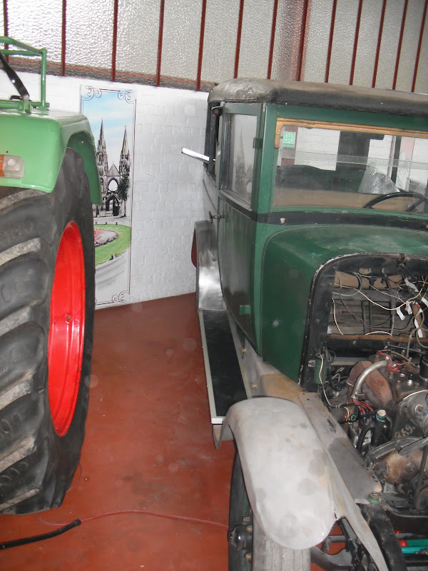

A day off on friday, so some progress made:
Foot step assembled and fitted.
Some parts coming back from the shop. Sure they already had good sheet metal workers in 1928. And we have a good one today to restore it. ;-)

PostPosted: Sat Apr 06, 2013 9:39 am
The roof bows look really good! Most American restorers/hot rodders pull off the canvas roof cover and find the wooden bows underneath are all dry rotted or so warped that they don't even make good patterns. Is the body shell of the car supported by metal bracing or wood? I see it's got Houlidale style friction shocks which are rebuildable.
Keep the photos coming! your work so far looks great :D

In this restoration, we have a huge avantage: the car is in our familly since more of 40 years: so we know its exact state before starting working: so, at this point: no real bad surprise.
bdk: we are hosted by one of our relative: very beautifull and confortable workshop, we are luky.
