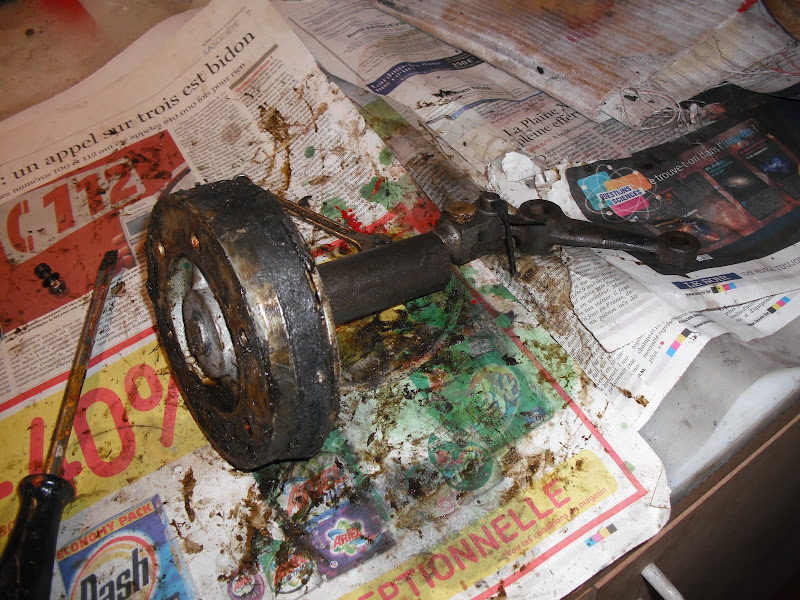

We are working on the brakes system. On this car, a master cylinder use a vacuum from the engine to assist the brakes:
Starting to disconnect the linkage
The cylinder after been removed: stuck by 85 years old grease.

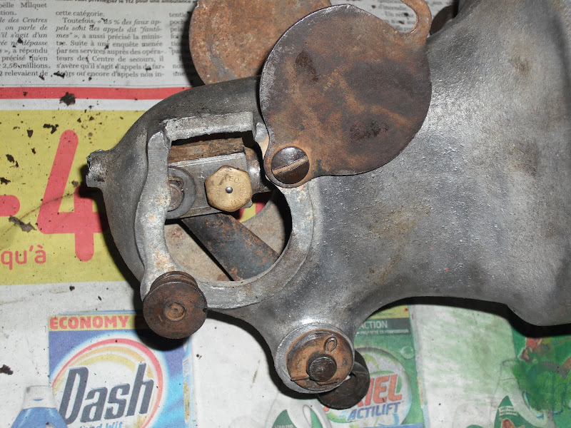

The body of the brake cylinder

That brake booster looks like it could stop a semi tractor :shock: Whoever was the last person to put it together did an excellent job!

My father drove this car 40 years ago, with this "brake booster" inoperative (Thanks The inspector, I learnt the correct english word ;-)
At this time, the car had logically, very poor breaking capabilities.
I received last week the set of new seals, this coming week-end: cleaning and reassembly.

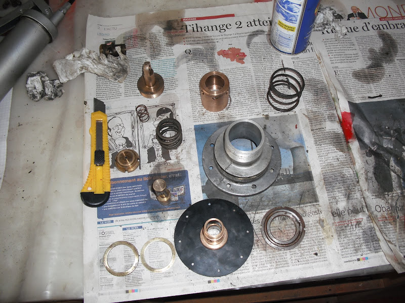

The brakes booster distribution valves disassembled and cleaned
Reassembling
Complete
And back on the car
