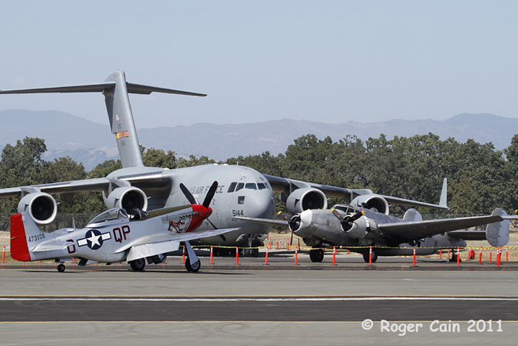

At the Santa Rosa Wings Over Wine Country air show.
