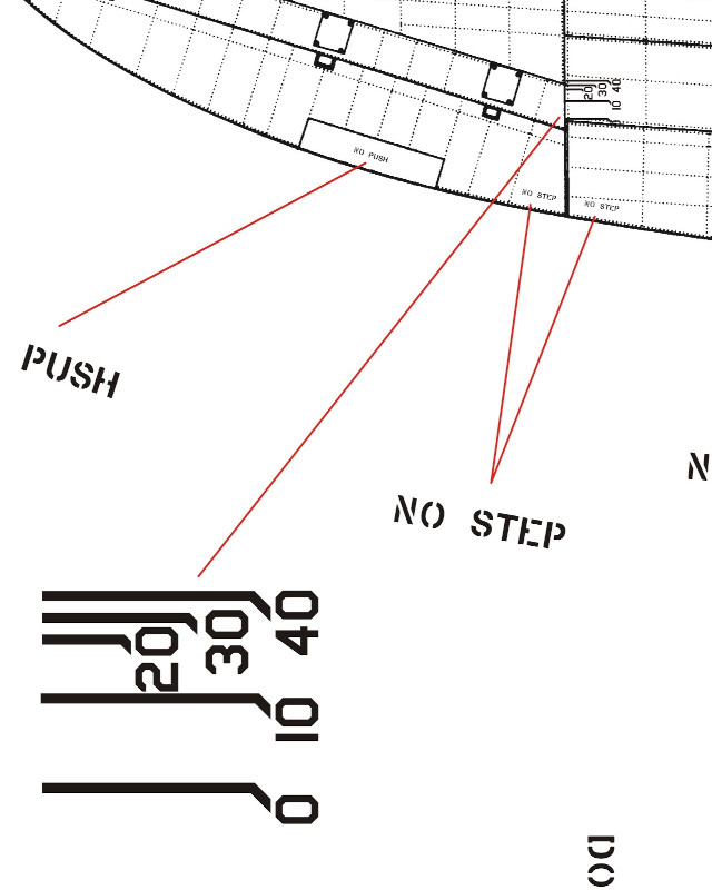

What is the purpose of the white lines on the leading edge of the wing near the guns?
(Source: Preflight Study Manual for Civil Air Patrol Cadets (Headquarters AAF, Office of Flying Safety, n.d.) 3-7.)
The explanations I have come up with or heard so far is that they are either for boresighting the guns, measuring wind drift angle, or bomb aiming.

these lines are for guns identification, they were on P47B number 7 up to 47 only. colors were white, yellow, red & green in add
"no step" on trailing edge and "no push" on trim tab are only on warbird, not on WW2 airplane
Wow, that was a quick answer! Thanks!
