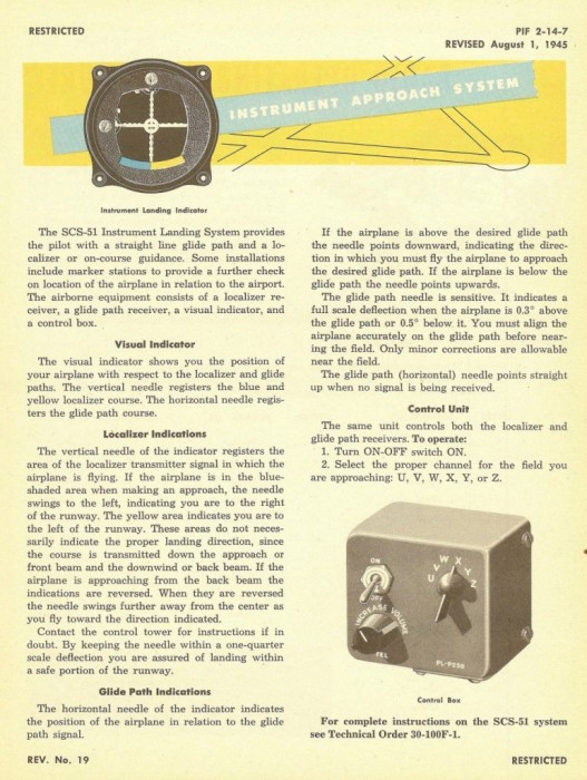

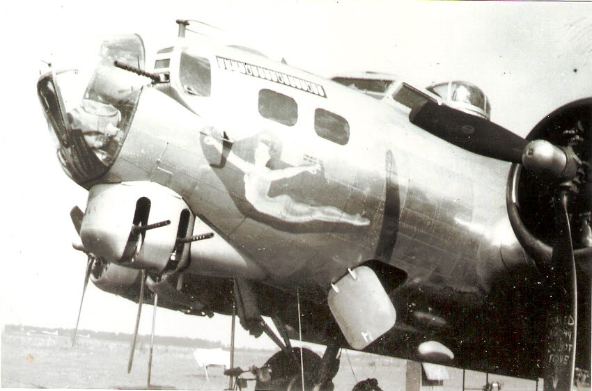

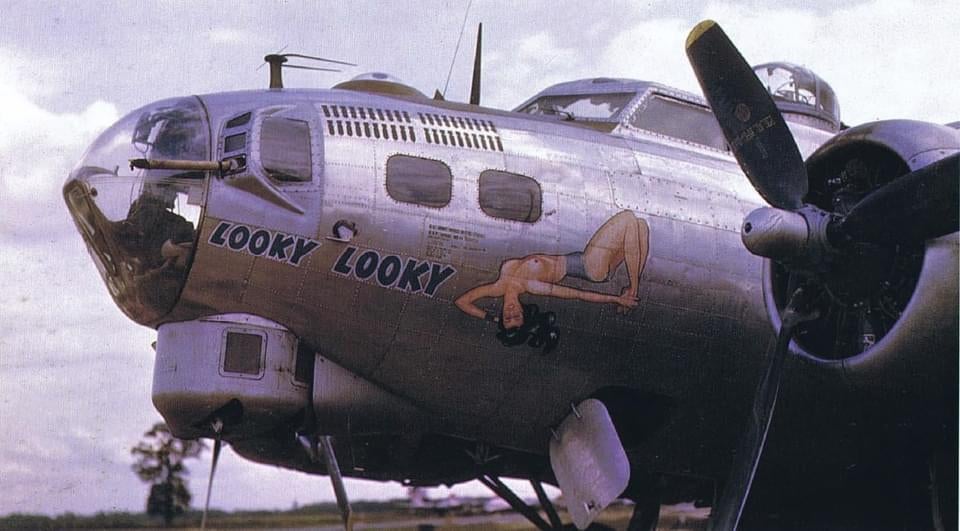

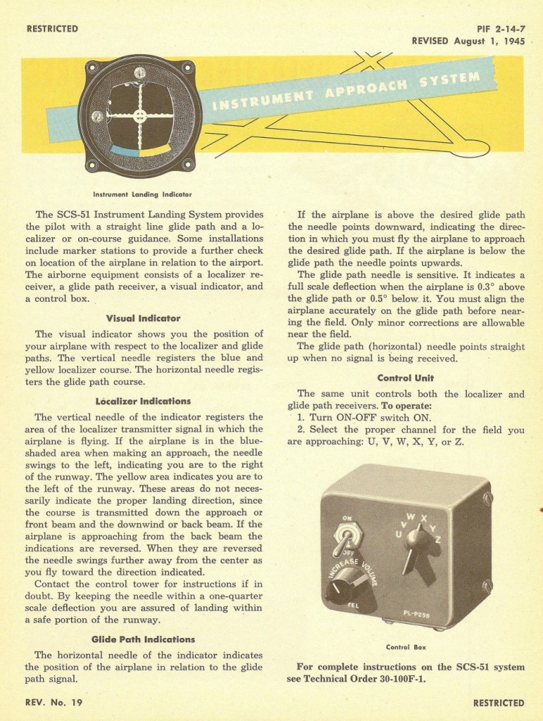

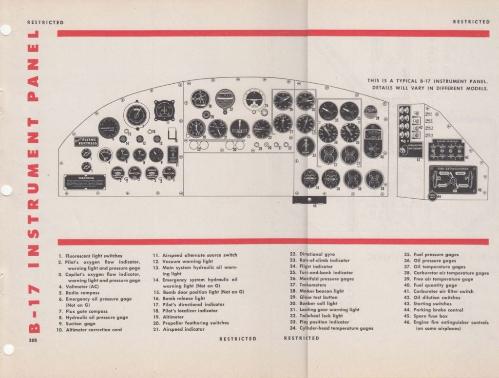

The RC-103 instrument approach equipment along with marker beacons and glideslope receivers were in use late in WWII. It can be seen in the B-17 photos showing the antennas for localizer and glideslope on top of the nose. It can also be seen on the instrument panels and is referenced in the Pilots Information file.
Number 18
The antenna for localizer and glideslope in front of the astrodome
Incidentally the frequencies used for the ILS, and even marker beacons in WWII, are the same frequencies used today. The present ILS system hasn't really changed that much since WWII.

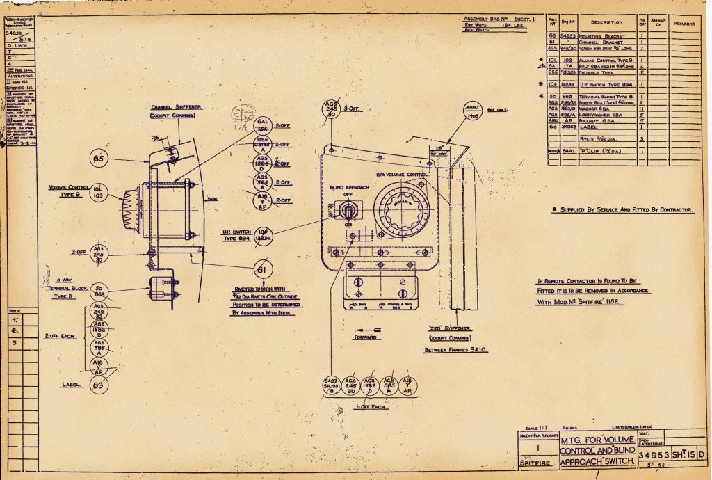

PostPosted: Mon Jun 14, 2021 4:18 am
Posts: 334
Feb 1944 for MkV Spitfires.Looks like backdated.
