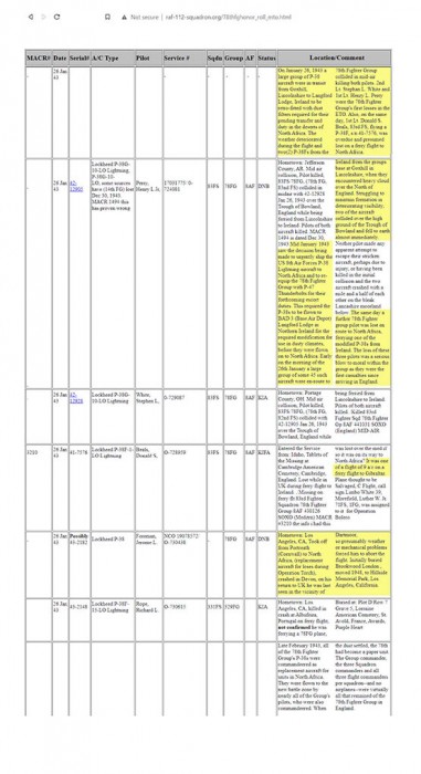

bdk: thanks you for the information on 41-2369; that's one more option to cross off the list. I don't know if there was ever a P-38 with serial 42-2369.
Mike Furline: thanks to you too for your reply. The article in The Gibraltar Magazine appears to be based on information from the IDPF; an agreeably-written story. The MACR you mention does indeed refer to another aircraft on the same flight, but which was unfortunately never found. I have attached an edited version of information published in the 78FG Roll of Honour. As you will see, a group of P-38s left Goxhill for Langford Lodge (Northern Ireland) to have dust filters for desert operations fitted to their aircraft before leaving for overseas. On the way 2 aircraft collided and crashed, with the loss of both pilots. Later, after leaving Portreath, another aircraft was lost near Portugal.
