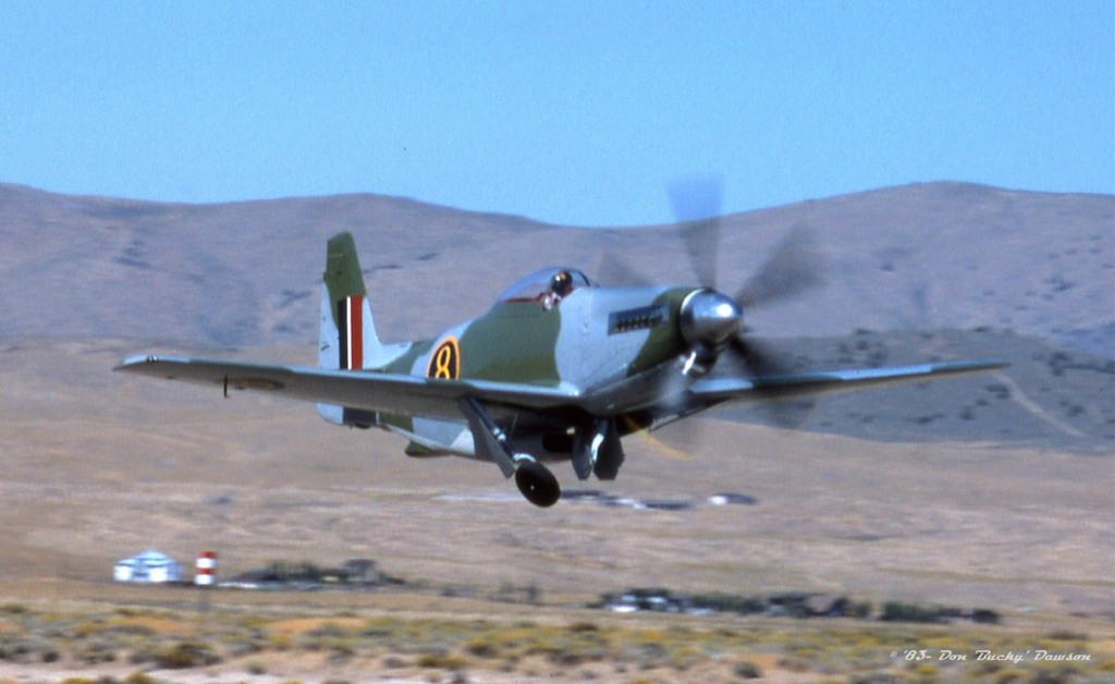

"Best" is often a word that causes problems. Surely it was fast, and had a great climb ability, but without the fuselage tank, it likely lacked range, one of the useful traits of the Mustang. Sounds like a real hot rod. I recall that a few pilots were not as keen on the handing of the H (was it Yeager?) feeling more comfortable with the D.
It is great looking, the three bladed prop on a bubble canopy P-51 sure gives a unique look.
The pic of Zero EB-200 (#3372) was just too good not to sneak in! Thanks for posting!

not a real one, but still fun to look at..... 8)
pop2
This is the Whittington P-51H with a five blade wooden Rotol propeller.
