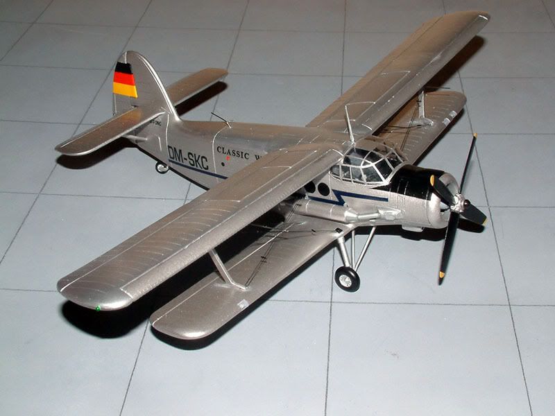

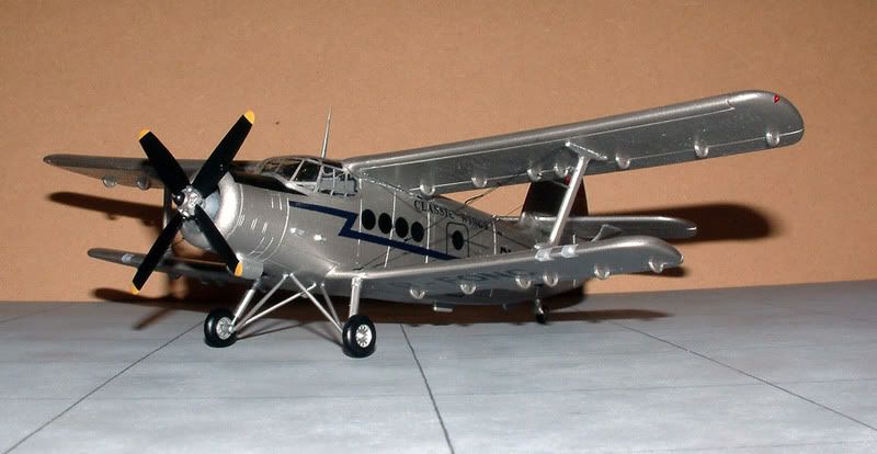

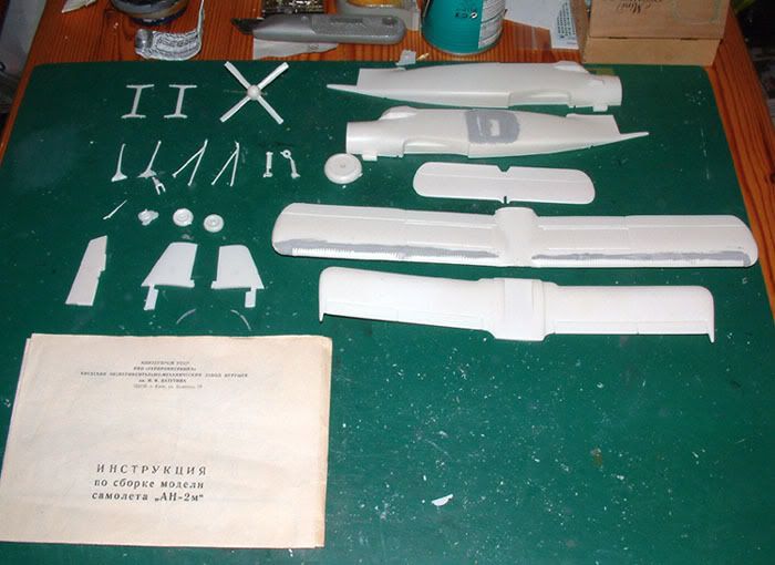

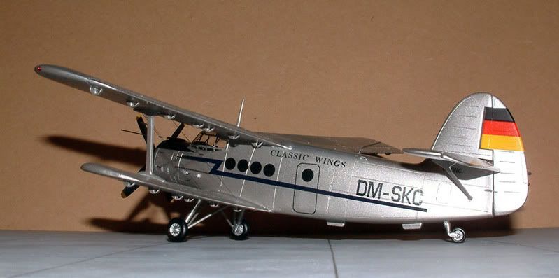

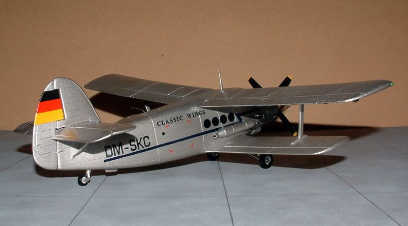

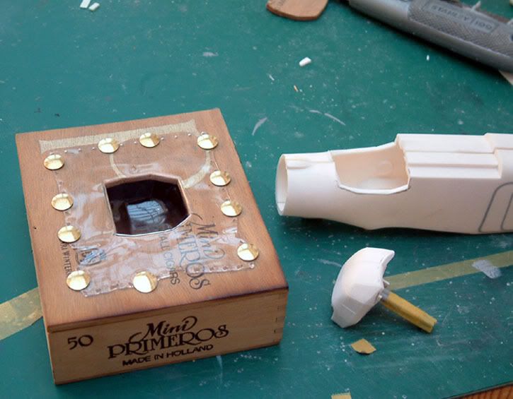

Built from an unknown kit of Russian origin, with a plunge formed canopy and home made decals.
:drink3:
Darius
Holding on in quiet desparation is the English way
PostPosted: Sun Oct 28, 2007 10:18 pm
Posts: 4341
I'm speechless...spectacular work!

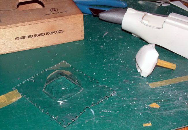

"Plunge formed canopy"? Whazzat? Like vacuum forming or are you stretching heated plastic over a plug??
Beautiful model by the way!
PostPosted: Mon Oct 29, 2007 10:21 pm
Posts: 4341
Sounds like the old "heat & smash" technique..pulling a sheet of heated plastic down over a "male" mold.
PostPosted: Tue Oct 30, 2007 1:20 am
Joined: Tue Apr 03, 2007 1:28 pm
Posts: 19
Location: Worthing UK
Steve
That's it exactly. I heated some clear plastic and drove the original solid kit canopy (that I had cut away from the fuselage) into it. It worked OK the first time.
8)
Darius
PostPosted: Tue Oct 30, 2007 1:58 am
Posts: 4341
Great work..how'd you manage to get the undercuts on the canopy?
PostPosted: Wed Oct 31, 2007 1:26 am
Posts: 19
Steve
I cut the canopy from the backing sheet with some plastic remaining beyond the "plunge form" line and then cut/folded/profiled the excess back to form the undercut.
