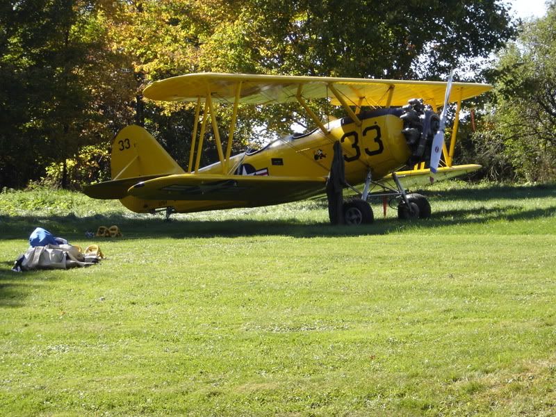

All the tips have already been said. But I have prop'd alone before and still the Number 1 rule, treat the prop as mags always hot!! When I worked for a banner tow outfit, we prop'd from behind at the doorway. Our mag switches were located right there on the right side of the panel. I would put my left foot infront of the tire, it took some getting used to but never had a issue.
http://www.youtube.com/watch?v=NM_eH6Zw ... re=related
This vid is not quite right but is one of the airplanes I worked on, he looks a little close to me but if your back by the tire, its not a issue.
Now this is ME!!! We have never had a electrical system in our N. We have been hand proping her since her 1st flight after restoration in 1976.
http://www.youtube.com/watch?v=63C95rsaHZQ

The only time a solo start is in the back yard. Thats not her normal parking spot but between those BIG chocks. She isnt going anywhere!! Those are old Northeast Airlines for DC-3's!!!
You are right on indexing the prop on installation. We did exactly that at the banner tow outfit. The other bonus was impulse couplings on both mags. They were really easy to start. But when we bolted a O-540 on a cub, it started out with no starter but on that one the firing order would change where the prop was when on compression stroke so if it did not start, we would go to off and pull it around again to where it would fire on the downward throw at the 7 oclock from the front!! We eventually did put a starter on it for safety and I was glad. The only other time I was pushing the issue on hand starting was a Weatherly 450 with the Hartzell 3 blade. I got it started after the battery died for a friend but I swore I would not do that again and havent...............2 blade ham, not a problem tho.
