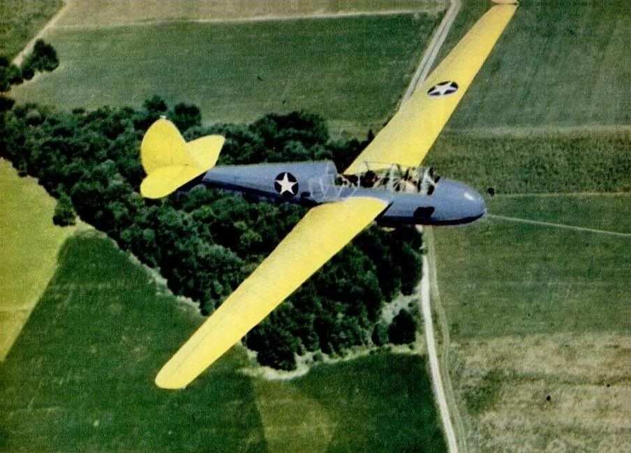

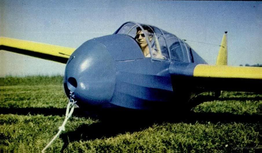

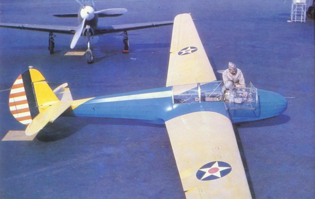

Here are two color photos from Popular Science sometime after 1 March 1943 when the T.O. was change to bring training aircraft in line with combat types with asymmetrical wing insignia and fuselage insignia, but it still missing the radio call number.
My favorite TG-4 paint scheme is the pre-war scheme with the red center circle on the insignia and full rudder striping, with what I think is one the XTG-4, nice touch with the yellow empennage color sweeping onto the fuselage and the blue sweeping onto the wings.

Once again Tom, those are some great pictures! Keep them coming, they are answering all sorts of questions I have - pitot and antenna location etc!
The one and only page of plans that I have (paint and markings) calls for the markings shown in that instructor-less(?) airborne photo - I had wondered why some photos I had seen had US ARMY under the wings and yet these drawings did not. I know the date mine was accepted into service (at least into the depot) on May 11 1943 so I guess it should by rights have been silver. As I said earlier there is definite blue colouring to the turtle deck and the wing stubs so I am assuming that mine would have had the fuselage stars and assymetrical wing stars. With a mid 43 date of delivery I wonder if my TG even saw any service at all with the plethora of engineless cub/aeroncas/taylorcrafts in service by then or whether it sat out the war in the Gaird St depot until being sold surplus in April 45?.

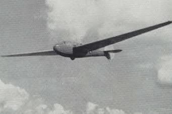

Here is a poor photo from some issue of Soaring magazine, probably from the same photo shoot as the Popular Science set since it looks to me that it has the asymmetrical wing star insignia.
I have to agree with you that your ship with such a late delivery date went straight into storage probably with aluminum dope overall for the last TG-4A accident at a glider training field, which looks to me as a joy ride gone horrible wrong, is on April 6, 1943 at Stuttgart AAFld AK assign to the 892nd Twin Engine Flying Training Squadron and probably being held in storage after the glider school had been shut down.
