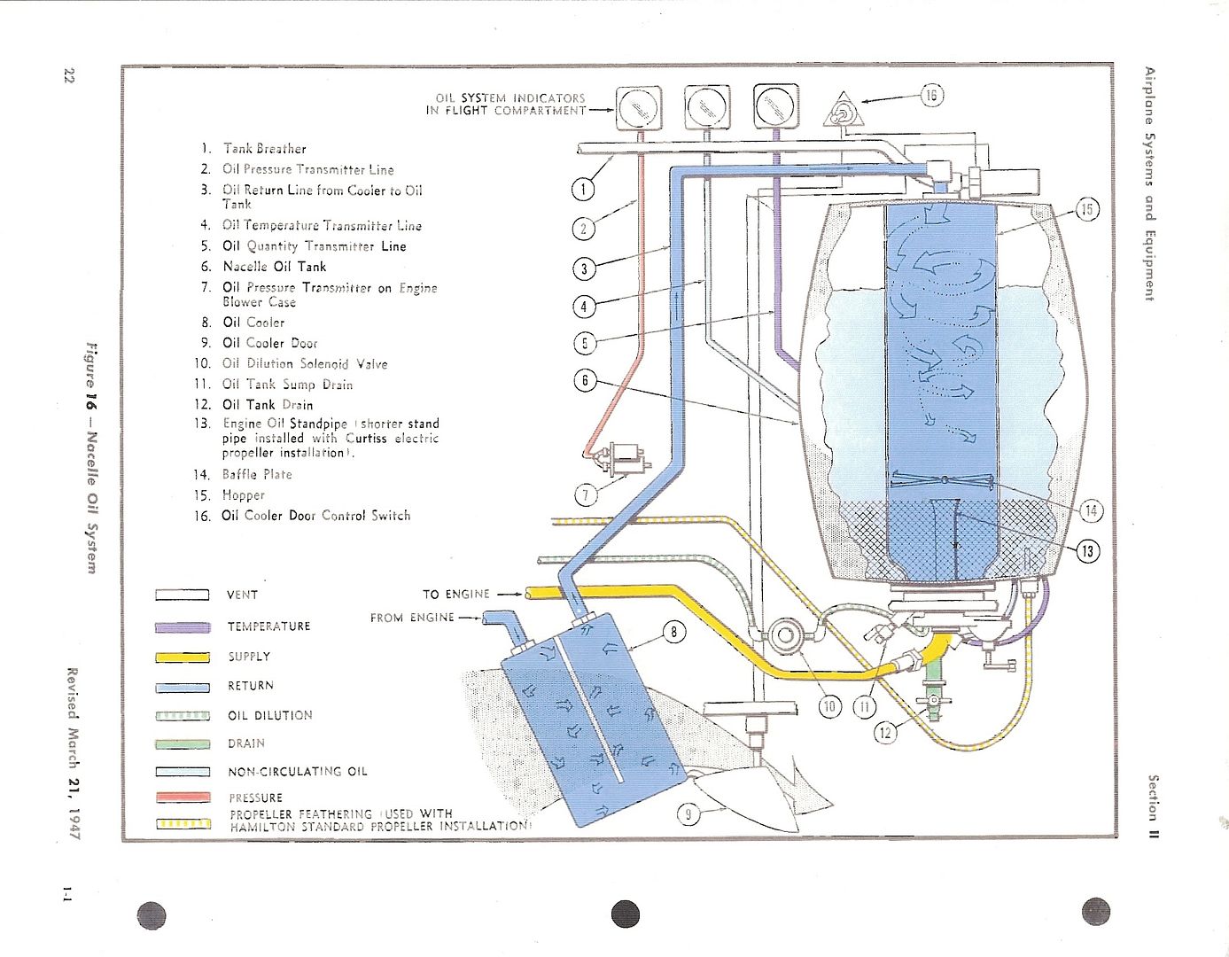

Here's a good depiction of the oil tank on an early DC-6 that shows the standpipe (item 13).The crosshatched oil below the top of the standpipe can only be accessed by running the feather pump.

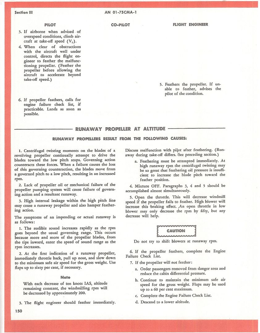

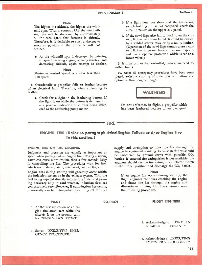

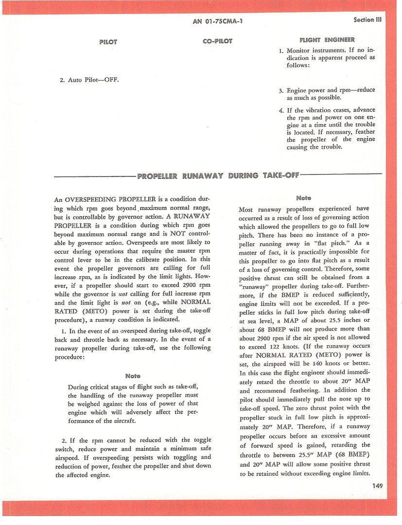

Here are pages from a flight manual for a Navy R7V-1 (Connie) concerning the Runaway Propeller Emergency Procedure.
As with Stoney,I had a runaway in a DC-7 just after take-off and used basically the procedure from the manual (the R7V procedure is the same as the DC-7 procedure).It think that it got to 3400 rpm and fortunately feathered okay (the normal take-off RPM is 2900).That said,the engine was frozen up after landing and the oil screens were full of metal.It ended up as a nosecase failure,but I don't know if that was the cause or the effect.I definitely don't want another runaway prop.Mine was #4 engine and I didn't hear any unusual noise from the prop,but things happen very rapidly.Fortunately,Dave Kelly (our Chief Pilot) was in the engineer seat and he pointed to the #4 tach,throttled back,tried bumping back the RPM with the toggle switch and immediately hit the feather button when the toggle switch had no effect.I reduced speed by pulling back on the yoke.We had a load of water on board for a practice drop and jettisoned that in a convenient field and landed without further theatrics.
Larry, I would say that there is a good similarity between this diagram and the B-17 tank fit.
The main difference seems that the feathering pick off point on the diagram shows it in an entirely different place to the B-17 which has both main oil and feathering oil pick off points directly next to each other into the fitting at the bottom of the tank into what the diagram calls a hopper.
The wording interests me in these manual notes.
It writes about propeller RPM for example as 2900, but my understanding is that the RPM is in fact for the engine and not the propeller as the tachometer giving the RPM indication, is driven by the engine with the propeller turning at many, many less revolutions by comparison.
I can't say what it would be in the this case as I do not know the ratio of the reduction gear fitted to this particular aeroplanes' engines.
