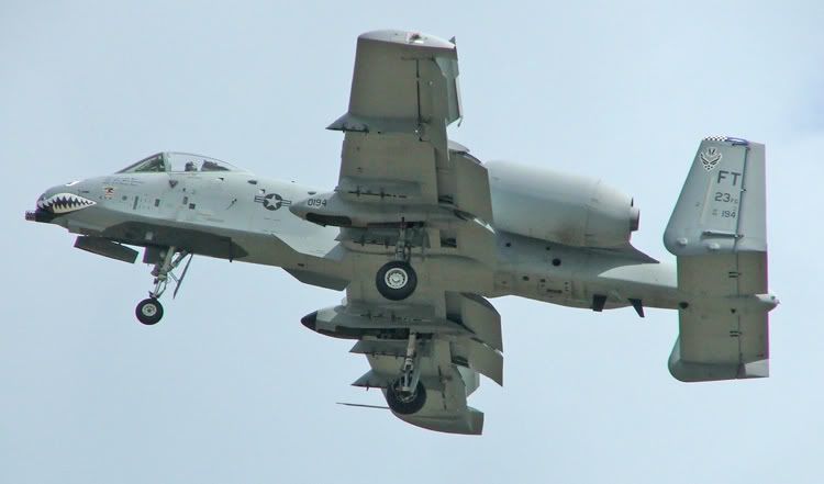

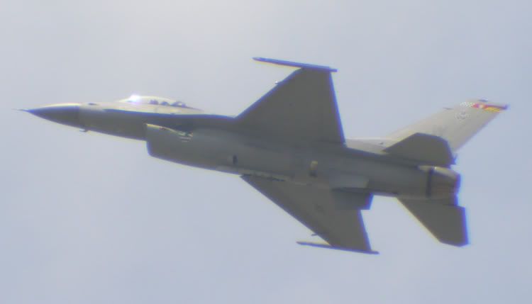

Pretty blurry... is it because of sun blur or motion blur?

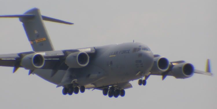

Blurry as well, but it is landing, it can't really be motion blur can it? Is it more sun?
This one is blown up a bit but it is not too bad, but a bit blurry... I'm guessing from motion? It was a high speed pass.

First off, there's no such thing as sun blur. Blur is caused by one of 3 things, (1) motion (2) out of focus (3) unsharp lens.
The first two pictures have strange color fringing (blue/purple edges) and I notice this is mostly at the edges of the pictures. This makes me suspect unsharp lens. By any chance are you using one of those screw-on teleconverters? They can sometimes produce effects like that. The F-16 may also have some motion blur but the center of the C-17 is actually reasonably sharp, it's just at the edges that it goes to heck.
With the others, the problem could be focus or motion blur or both. The way to tell is, if you look at the pictures at full resolution, blur due to motion (either subject motion or camera shake) will be directional, i.e., it will be more severe along horizontal edges than vertical edges, or sometimes it is diagonal -- whatever direction the camera moved relative to the subject. If all edges are equally soft, it's probably focus blur. That looks like the problem with the Sabre and the first P-47 pic. Maybe your AF system had trouble tracking the subject. Based on the degree of prop blur in the P-47 pic, you seem to be using a high enough shutter speed that unless you are quite bad at panning, focus may be the more likely problem.
The Heritage Flight pics are reasonably sharp, especially the second one. I do still see a little color fringing though -- note that the P-38 wing is edged with blue on the left, red on the right -- which suggests lens quality issues. Don't see any blur problem with the final two pics either. That also suggests a focus issue with your softer pics -- sometimes the AF is locking on, sometimes it isn't.

It looks like you have a couple of issues going on. 1. Purple Fringing 2. Blurring or Softness.
1.Purple Fringing is the purple chromatic aberration that you notice especially in the first couple of shots. It is the purple band on the border of the high contrast area between the aircraft and the sky. There are many causes of this, some have more to do with the lens and sensor of the camera however there are many ways to help control the purple fringing and since your camera seems to be capable of some manual settings you probably can help reduce this.
One factor that has been known to contribute to purple fringing is having a rather large wide aperture. In this photo your aperture is f4.5 well within the "danger zone" or purple fringing. If possible when shooting in a high contrast situation (dark plane against bright sky) see if you can keep your aperture smaller than f5 (lower number wider the aperture).
You can do this a couple of ways. If your camera has aperture priority mode you can set your aperture to a certain number. Although this would work it might give you undesired underexposure or shutter speeds that are too slow to catch the action. Another solution is to increase your ISO a bit. I noticed that this was taken at ISO 80. While as a general rule with digital it is nice to use the lowest ISO you can to reduce noise it may be worth while to manually set the ISO to 100 or even 200 to keep your aperture narrow and your shutter speeds up. Go up to 400 and you will probably start to see some noticeable noise. One nice thing is about noise is that it is easy to fix with software were as exposure or blur issues are a little more difficult in my experience. It is also fair to take maybe a stop or 2 away from your shutter speed and give it to your aperture because 1/500th should be fast enough for most applications.
2. Blurring and softness can be caused by a lot of factors that can't be changed including the lenses, sensor, image processor and image stabilization however there are many things you can do to to get crisper pictures.
Going back to the aperture. Usually the wider the aperture the softer the picture. Get the aperture stopped down a bit and you will get pictures that are a little more crisp. Again you can use the ISO might be the easiest way to do this. Another thing is that your camera has 10x zoom but no image stabilization. This can be an issue because when you zoom in 10x every movement and vibration your body makes is being amplified hundreds of times over the distance between you and the subject. You can try and pull back your zoom a tad bit to keep the movement down. The movement will cause you blurry and soft images. your camera is 10MP which gives you a little bit of leeway in cropping so if you don't zoom quite as deep you can still crop the photo tighter and still get a decent resolution print. If you notice the 2 P-47s are much more crisp than the top F-16 and not much purple fringe. The 2 P-47s are a slightly smaller aperture and a significantly less focal length which I think has made for more crisp and clear picture.

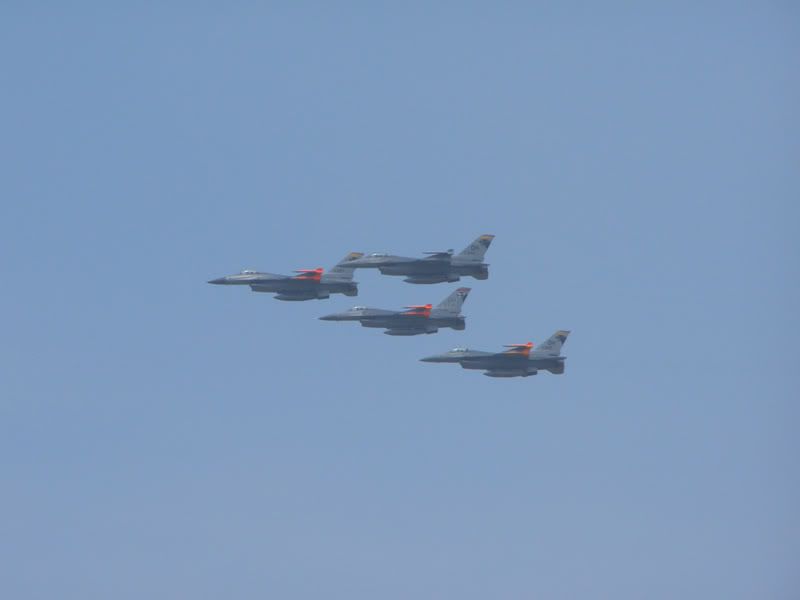

In regards to zooming out and then cropping. Here is a shot of 4 F-16s the flew over by surprise. I was about as far away from the flight line as possible and just put my camera up and see what it would do. The first is the origional photo. The next one is it cropped. There is noise, but I was amazed how clean the lines were for "shooting from the hip." I think I had this photo on my desktop for a bit, but a tad smaller and I was pretty happy with it actually. I was wondering how the lines were so defined from this distance, but blurred when I was on the crowd line. :?
Just guessing I think maybe that being farther away that you didn't have to pan as fast to keep up with the aircraft which made for a more steady hand. Also. noticed the f stop was 5.6 which is getting more out of the purple fringe danger zone. Don't see much if any purple fringing on that photo. Also, narrowing the aperture in general sharpens your image. Maybe just a combination of a lot of things.
