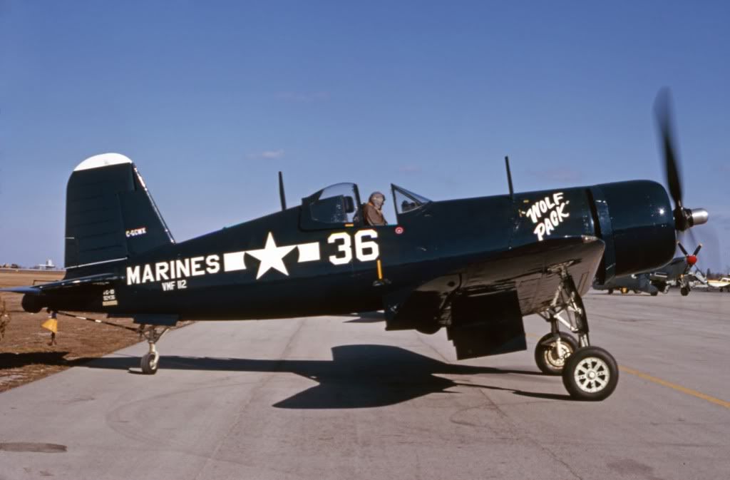

Doug Fisher sent me the photo of the former Canadian Warplane Heritage Corsair (which I had the honor of working on and flying in for 10 fun filled years as crew chief) arriving at CWH in 1973 in VMF112 garb.
I included a shot of it in the 1980's and the link to Airpowers photos of it under rebuild.
I know they will have it being likely the nicest Corsair flying!
Photo courtesy of Doug Fisher..
Photo from personal file.

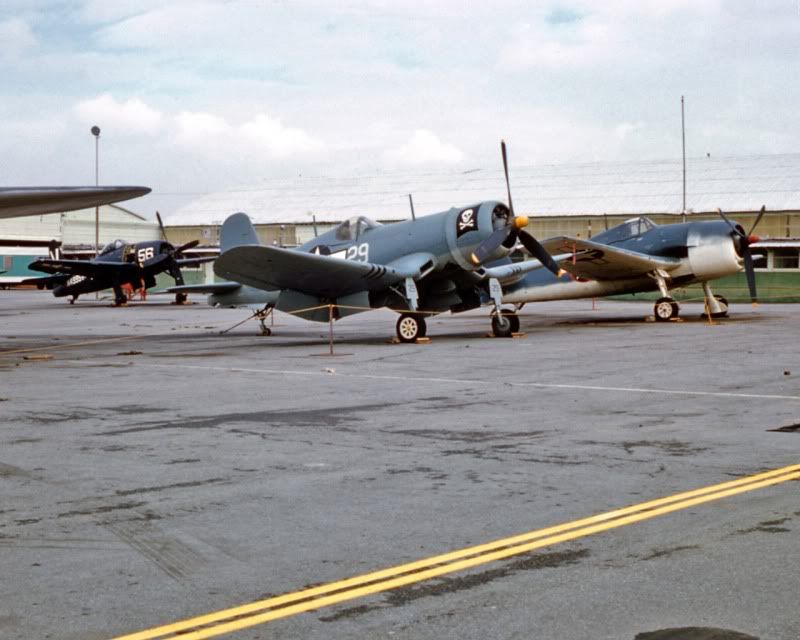

Mike, heres another picture of it taken at The Air Museum in 1962

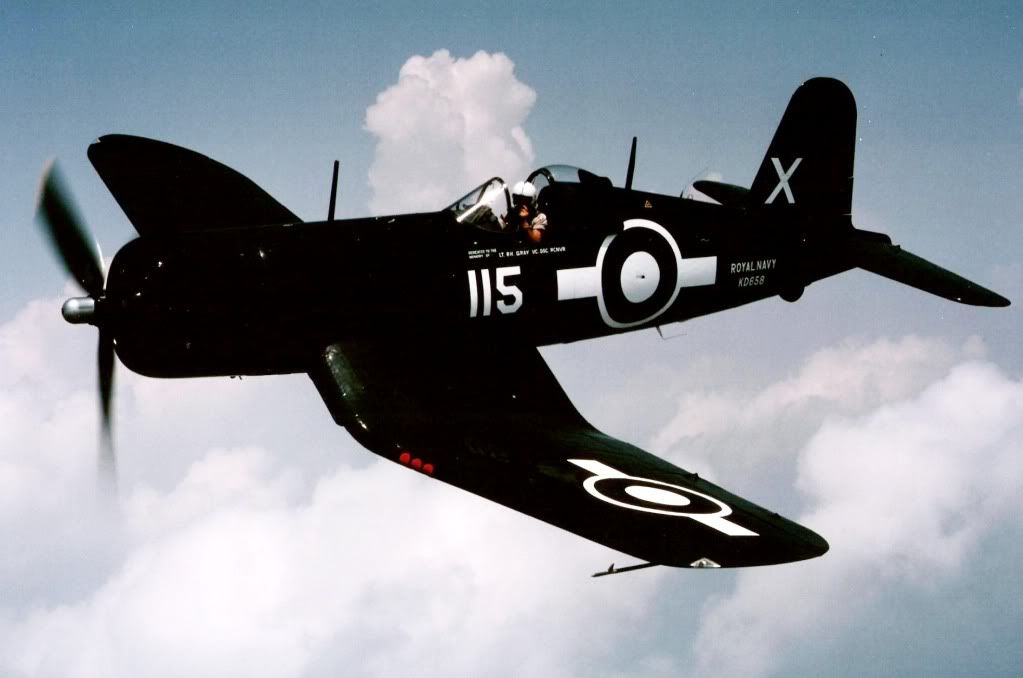

And at Oshkosh when it was coded 147
Doug

PostPosted: Mon Aug 24, 2009 8:21 pm
Posts: 332
Location: Smithville, ON
I hadn't seen it in the 1962 colors. Thanks Doug

PostPosted: Mon Aug 24, 2009 8:24 pm
Posts: 332
Just noticed it had the full tail wheel door in the 1962 photo. I wonder what happend to it to have it taken to a half door?

Its coming along nicely. The rear fuselage is done after they replaced the air stair door. Wing center section and outer wing panels are going together. There was a LOT of corrosion in the airplane and they had to dig into a lot more than they originally thought. John's crew is doing the usual incredible job on everything. Don

The lack of full tailwheel doors were cause for some of the corrosion that was found in the airplane. The vertical and horizontal stabs were in pretty nasty shape. The right side panel in the cockpit had a lot of automotive wiring in it. In the early 80s it was caught in a hail storm in Canada that tore up the fabric on the wings. It was replaced with sheetmetal. Unfortunately, when the rivets were shot in, several of the ribs were split. Once the interior of the back seat was taken out, the shoddy work done by Kal-aero when the door was added became apparant. Some of the rivet tails looked like they were just bent over flat with a hammer. The poor girl was still flying when we sent her to Idaho but I'm afraid she was in far worse shaped than we thought. Another year or so should have her back out in Washington as the nicest Corsair restoration yet. She and I may arrive around the same time!
