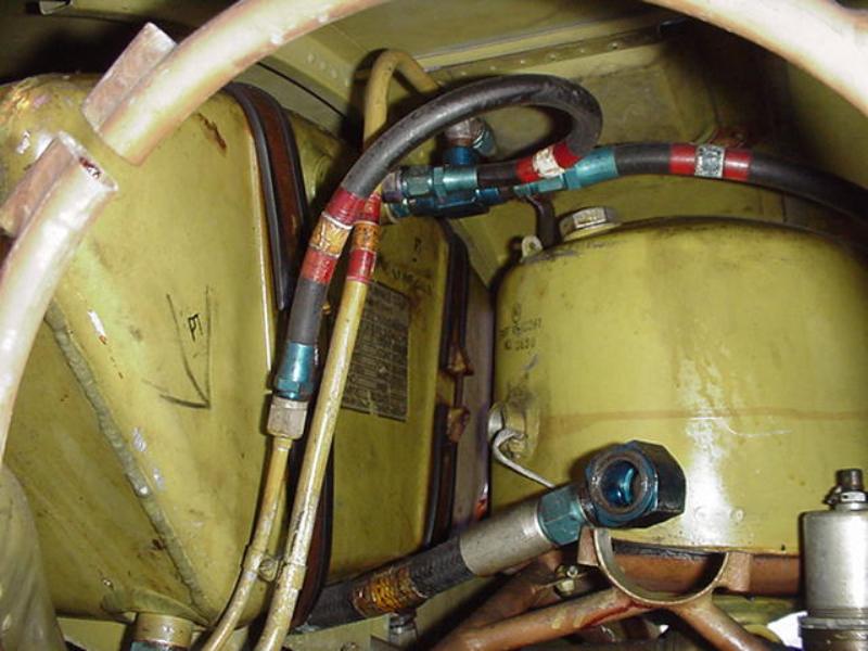

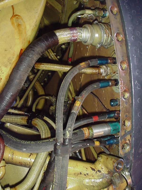

Here are some examples. Mark, you like Corsairs right? Here are some shots of the Fleet Air Arm FG-1D that you mentioned in your post. This aircraft is what I would call a true restoration as its caretaker, using British hydraulic fluid, hand rubbed off the outside later layers of post war museum paint to reveal the original factory finish underneath. Wow! well done. It’s only original once and this is a Corsair treasure of the highest magnitude.
here is the engine compartment and other interior shots that will give you an idea of what was done at the Chance Vought factory. Remember this aircraft was not restored in today's sense but it has been kept in a decent environment and preserved for the last 70 years. This is how they were built and it is perhaps the only original FG-1D left

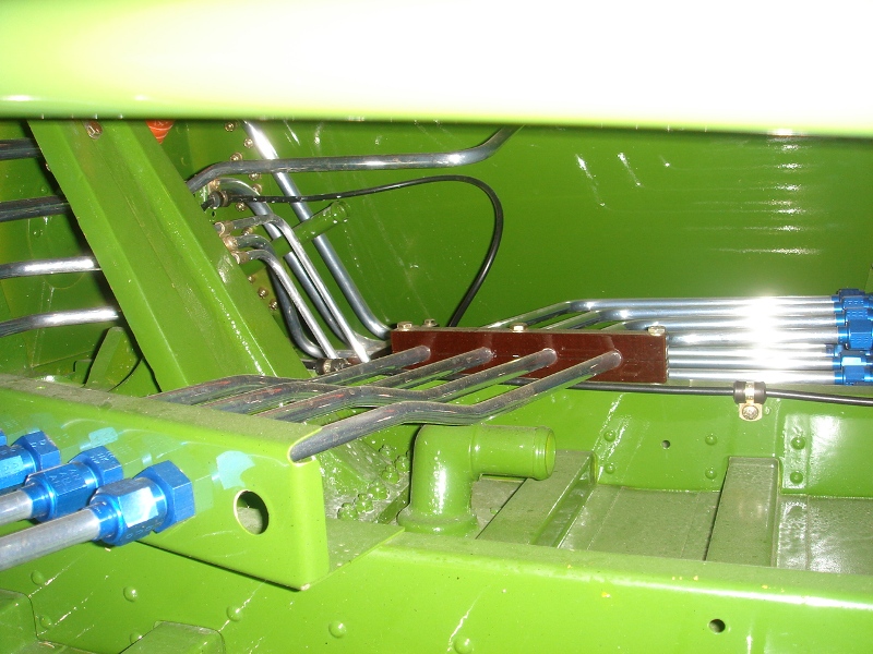

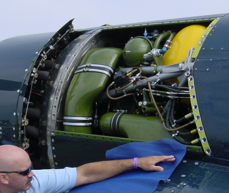

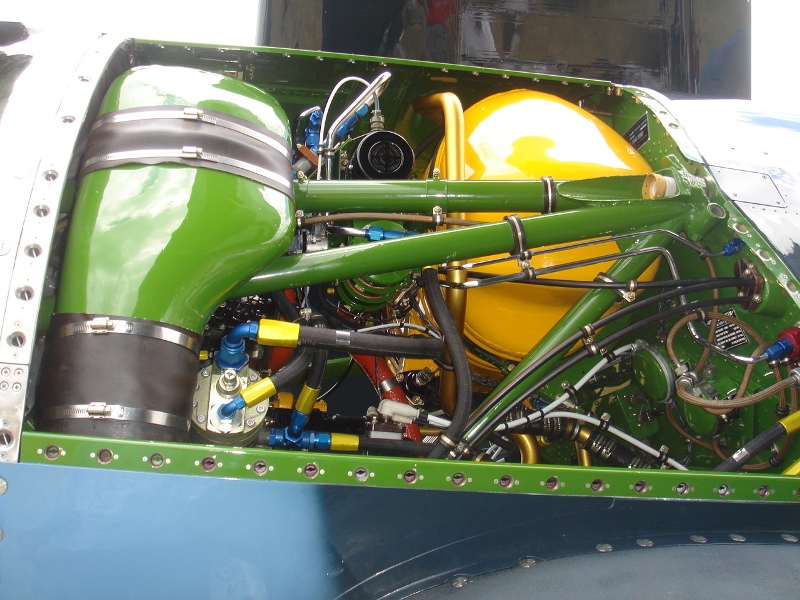

For comparison here is an FG-1D restoration that came to OSH one year.
There is no challenging that they spend a large amount of effort on this aircraft. I just have a hard time calling it a restoration. It is custom to me. The quality is there but the authenticity is not. Once again no problem if the owner wants this he is more than welcome to it but just understand that it may not be a winner if the competition is there to claim the authenticity points.

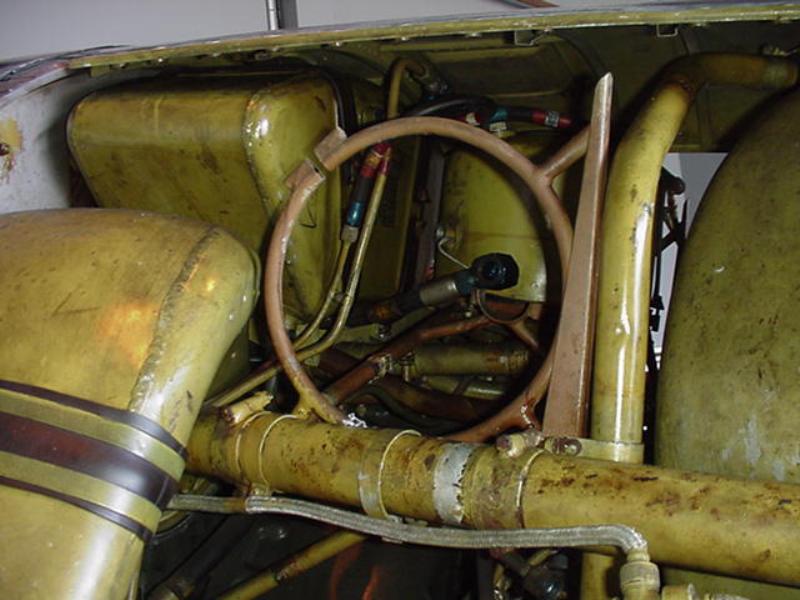

Here is another Corsair that came to OSH a different year.
Similar in that the gloss finish will be found on everything. Great effort has been spent but falls short on authenticity.
Yellow oil tanks sure are popular today. Because the color coding on the oil lines is yellow, folks like to paint the components in the oil system the same color. Trouble is this was not normally done in service especially on the Corsair. I have seen fuel components painted all red and I am waiting for hydraulic lines to be striped blue and yellow someday.
These details usually come from one guy's or one shops interpretation of what a restoration should be. I think its all in the research and it is this research that makes all of the difference when it comes to authenticity. You are going to spend about the same amount of effort in a ground up restoration but the difference is the effort put in before anything is done. It all depends on what you want to end up with. Maybe the details don't matter and the gloss paint is more pleasing to the owners eyes and is easier to wipe down. Then the research really doesn't matter. But if you want to go after an award at a place a bit more prestigious than the local fly in you will need to plan out the restoration and do the research long before the first wrench is turned or rivet drilled.

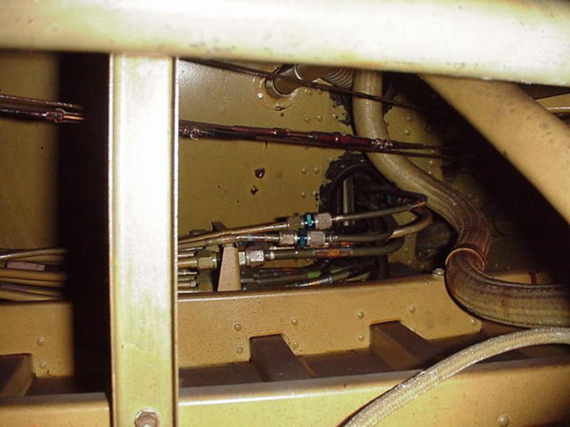

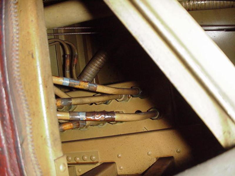

These are shots inside of the wing with hydraulic lines and fittings in the original condition as seen in the Fleet Air Arm's FG-1D KD-431. Just as they left the factory. Painted for corrosion protection that the US Navy demanded. Note the markings on the lines with part numbers and contents identification

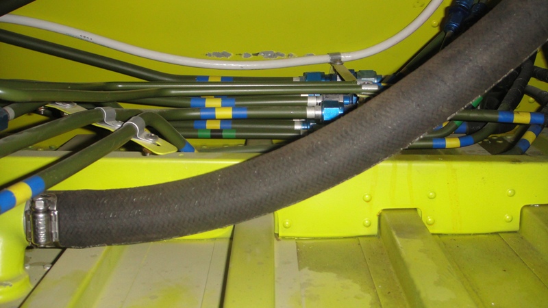

Here is one restoration
Lots of effort to polish the lines but they weren't polished in the Navy. Corrosion protection was paramount.
the same area in another restoration with better effort toward authenticity. Not all the way there but a lot better than the polishing...if authenticity is in the game plan.

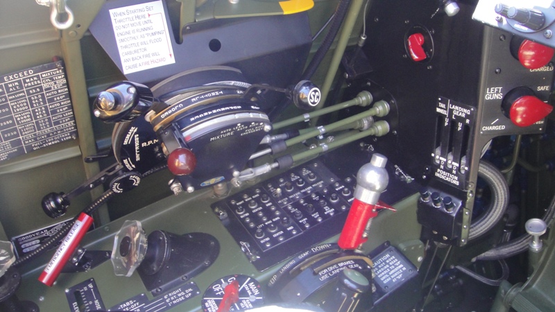

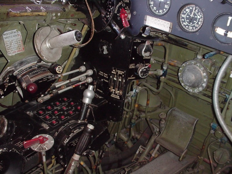

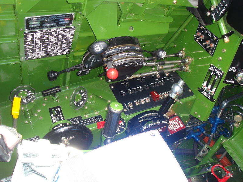

The throttle quadrant area of KD-431

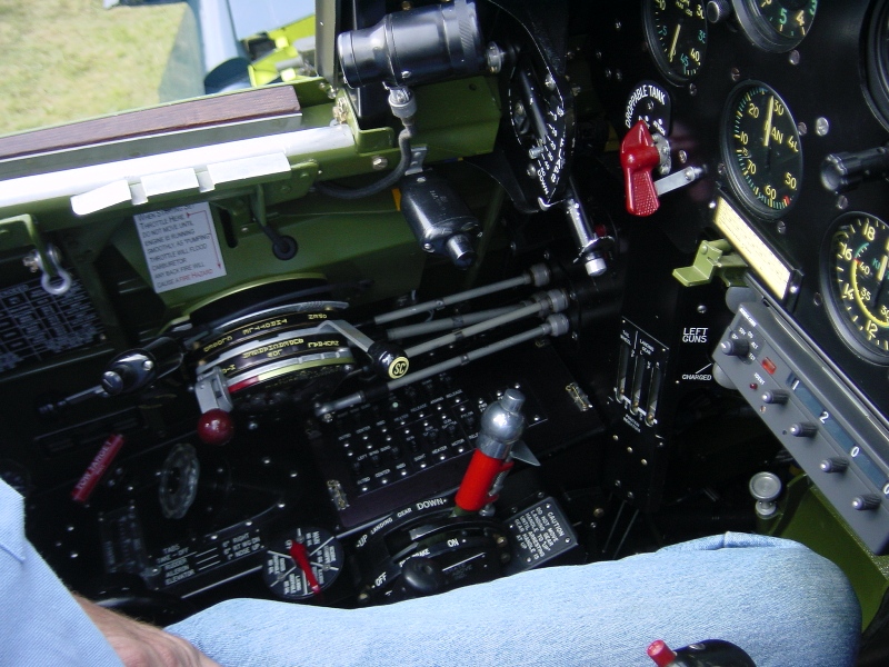

And the others
Each gets a bit more authentic and we keep seeing better and better restorations coming down the pike. This is great to see and it can be blamed on the restorers who go that extra mile to dig up more of the documentation to show why they did what they did.
