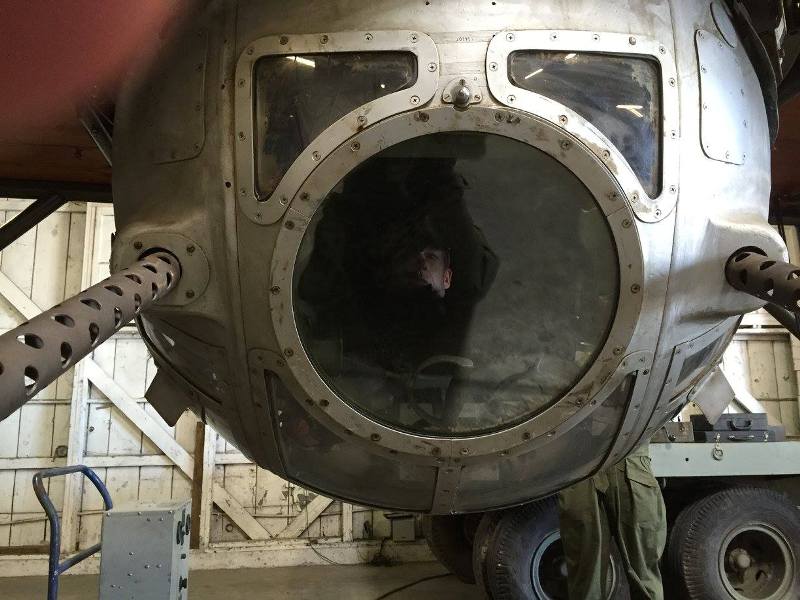

The Wirribee B-24 team have a ball turret on a stand, a striking exhibit!

PostPosted: Tue Dec 06, 2016 3:56 pm
Posts: 2148
Location: Utah
Pretty cool! There has got to be more than just the Wendover museum who would want a ball turret display like the one the Wirribee team has! If I could band together with a few folks and get one built. . . . :D

Note that the Wirribee turret has the ammunition cans mounted on the hanger assembly. In earlier versions, the ammo cans were located inside of the ball in front of the gunner (per the aforementioned manual).

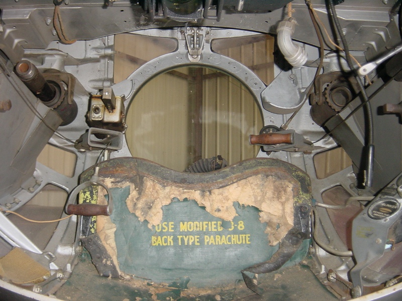

Here is a shot of the inside of an original unrestored ball turret. On the right side of the circular glass you can see the ball turret clock and its flex shaft just behind the right gun charging handle.
