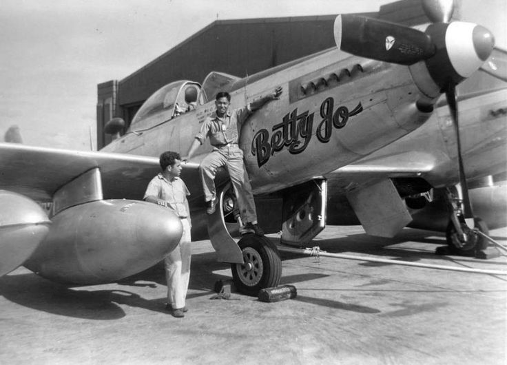

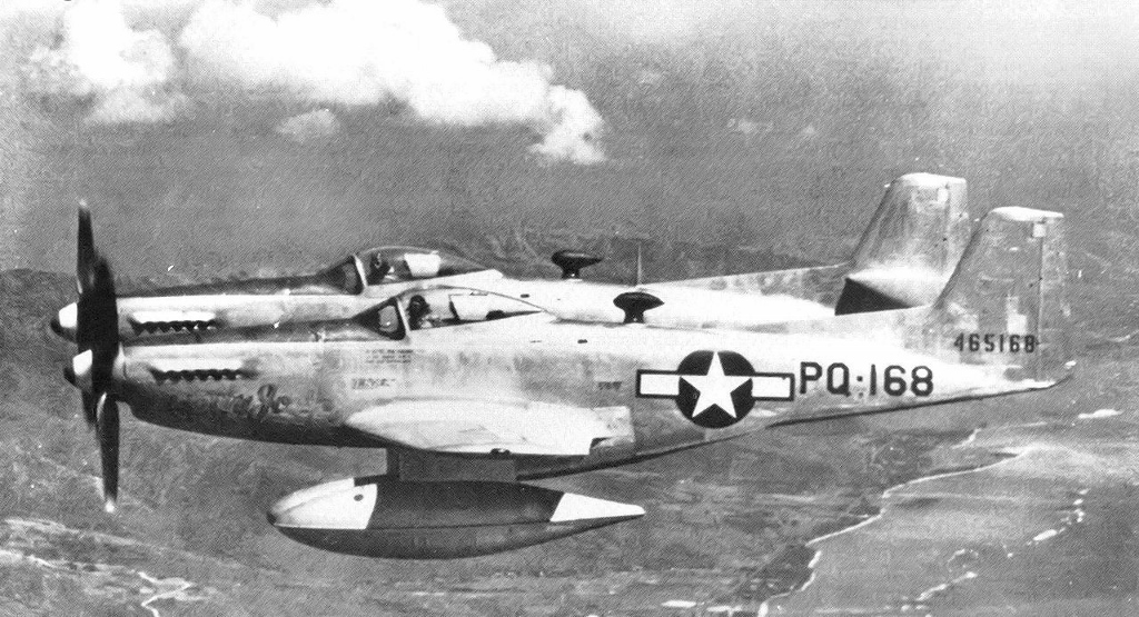

I don't know if any of these photos would help. Wikimedia says 310 gallon external tanks.
1280px-F-82B_Betty_Jo_44-65169_Flying_over_Los_Angeles_1947 (1024x462).jpg [ 356.64 KiB | Viewed 2799 times ]
1280px-F-82B_Betty_Jo_44-65169_during_record_flight_27_February_1947 (1024x555).jpg
1280px-F-82B_Betty_Jo_44-65169_during_record_flight_27_February_1947 (1024x555).jpg [ 404.76 KiB | Viewed 2799 times ]

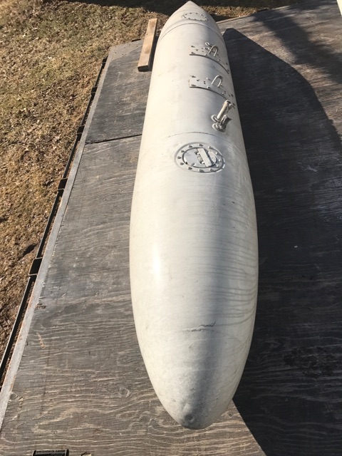

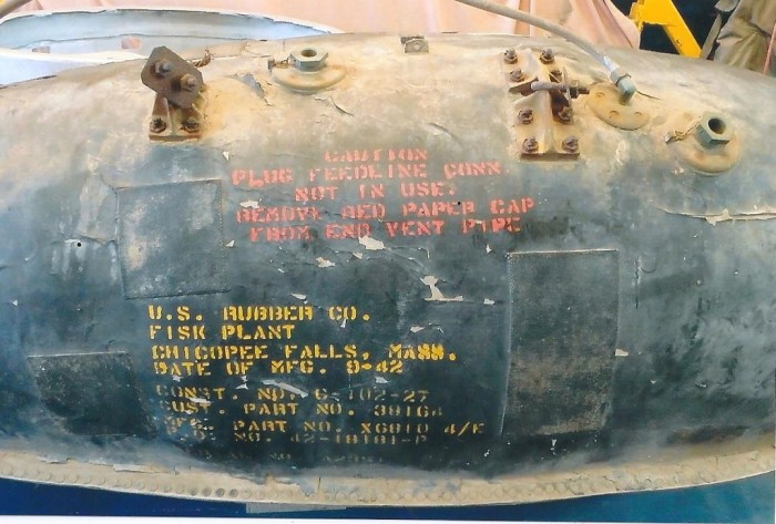

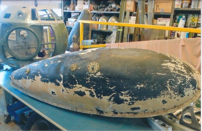

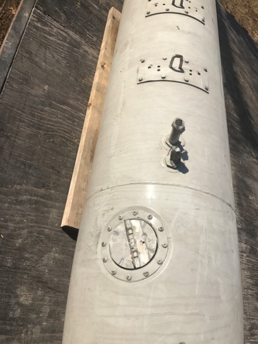

Thanks for the welcome everyone. I did not think my first post would elicit much of a response!

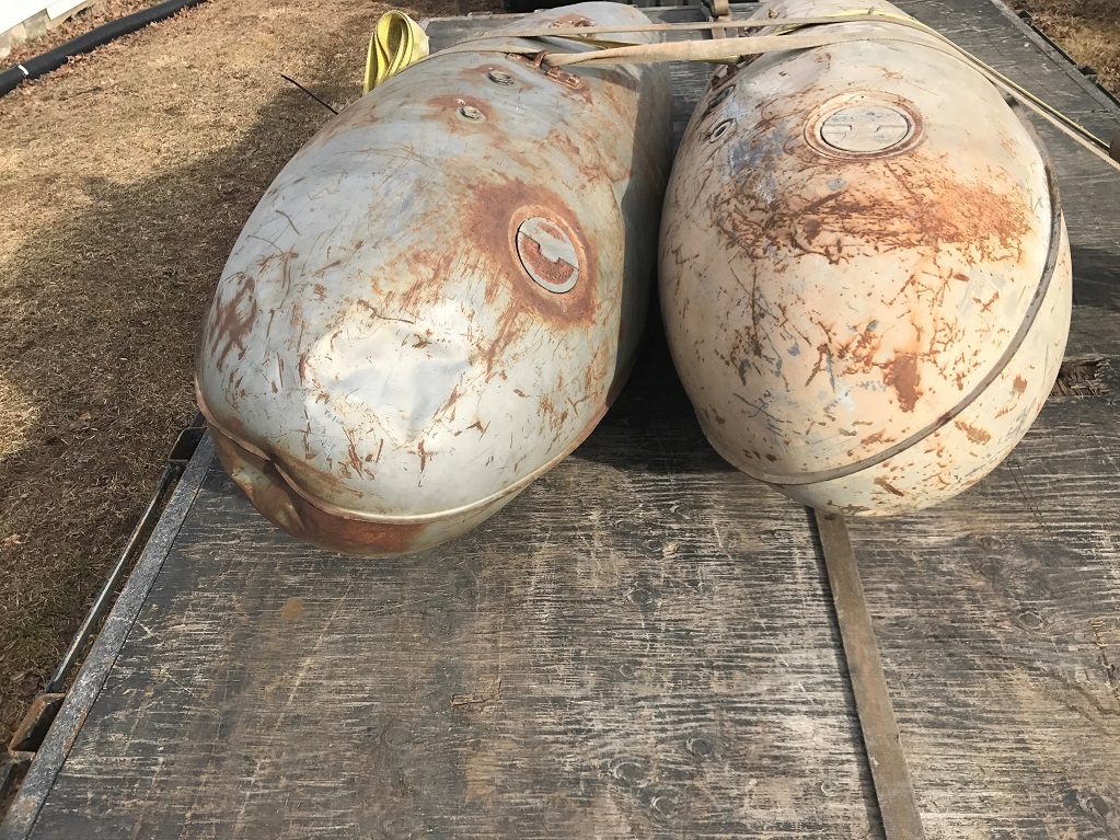

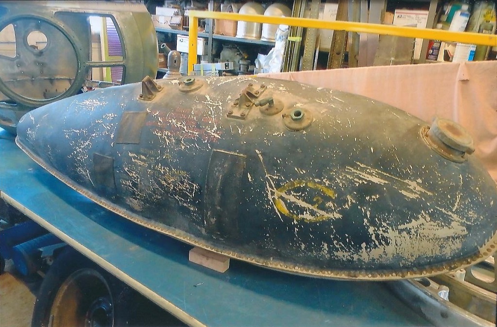

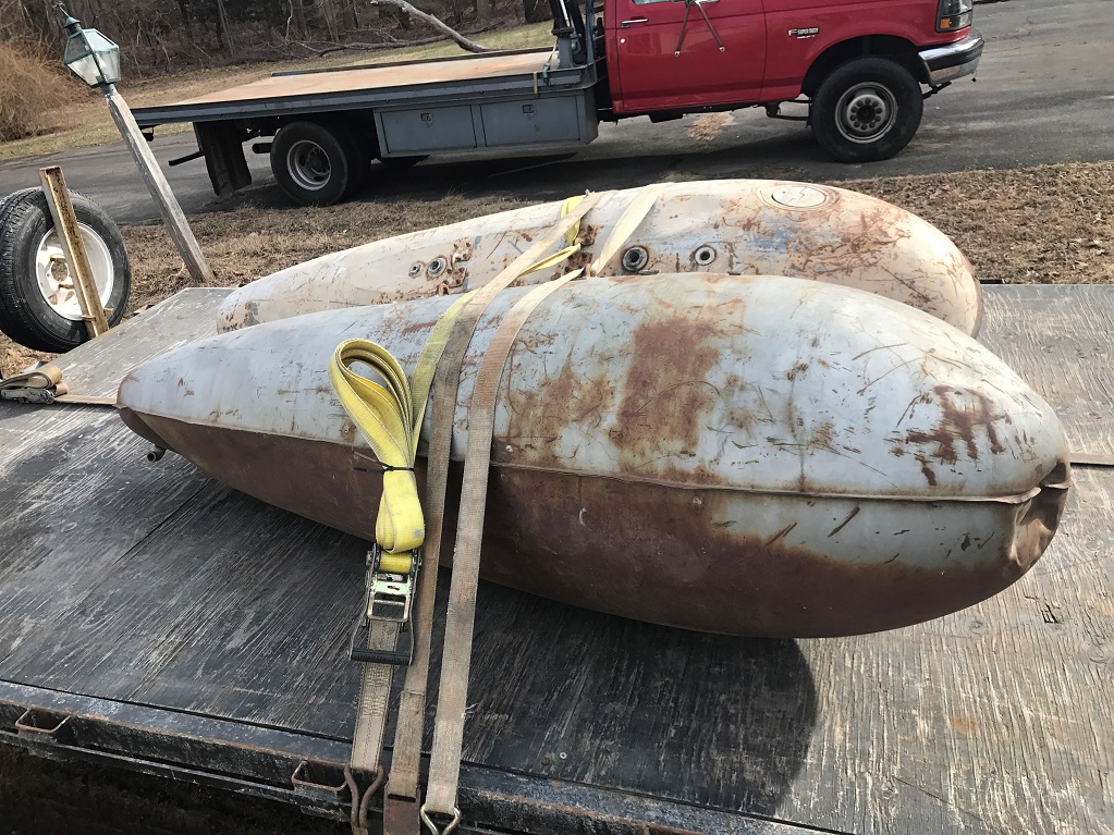

Noodling around on the interwebs, I found these photos of various drop tanks. The long skinny white ones look P/F-82ish. I found a google image picture of an F-82 in flight with very similar tanks, but I cant seem to find it now.
PostPosted: Thu Feb 07, 2019 6:13 pm
Something like this?
