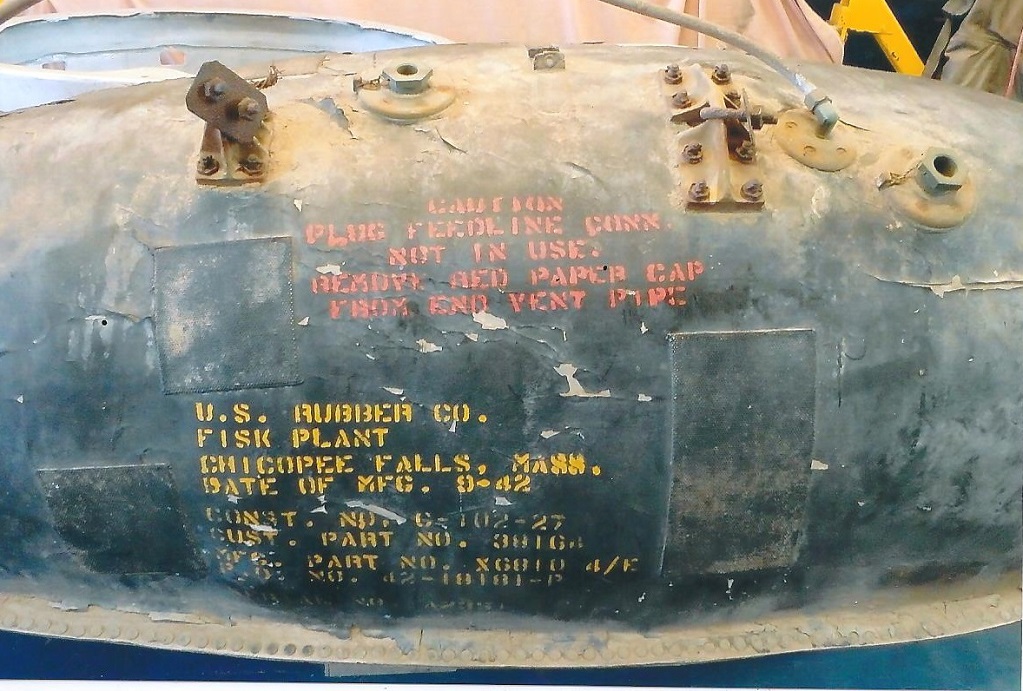

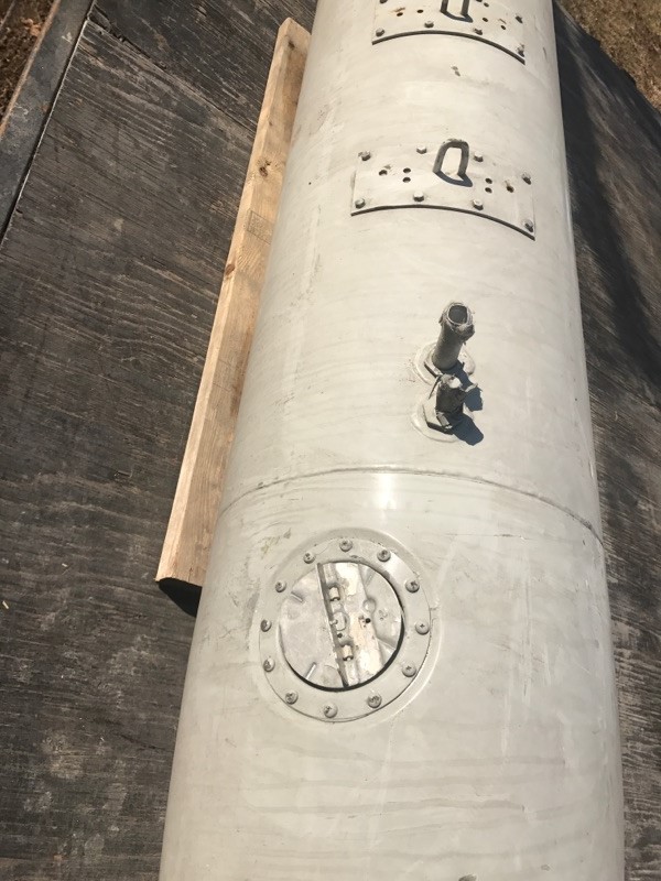

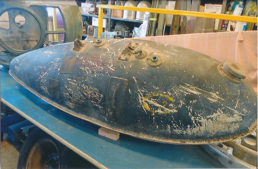

Noodling around on the interwebs, I found these photos of various drop tanks. The long skinny white ones look P/F-82ish. I found a google image picture of an F-82 in flight with very similar tanks, but I cant seem to find it now.
